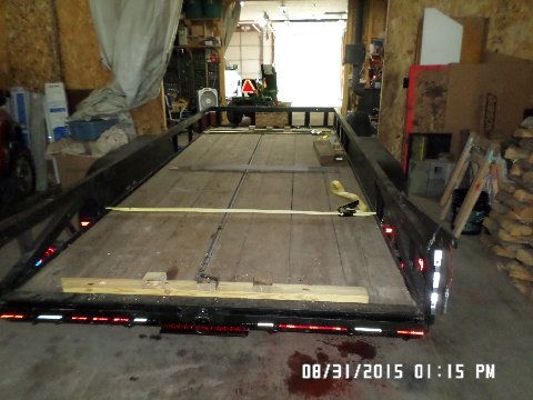

I am going to have at one concrete truck next year when I pour about a 20' by 10' sloped ramp in front of my barn. Then will be trucking in more gravel and some blacktop later...... putting a blacktop area in front of the barn. Picking up two 21' by 8" pipes tomorrow. The wall size is about .32"... Just prep'd my trailer for the pickup ... I will hump up some more gravel over them if I have to when the bigger loads are coming in.... :)
