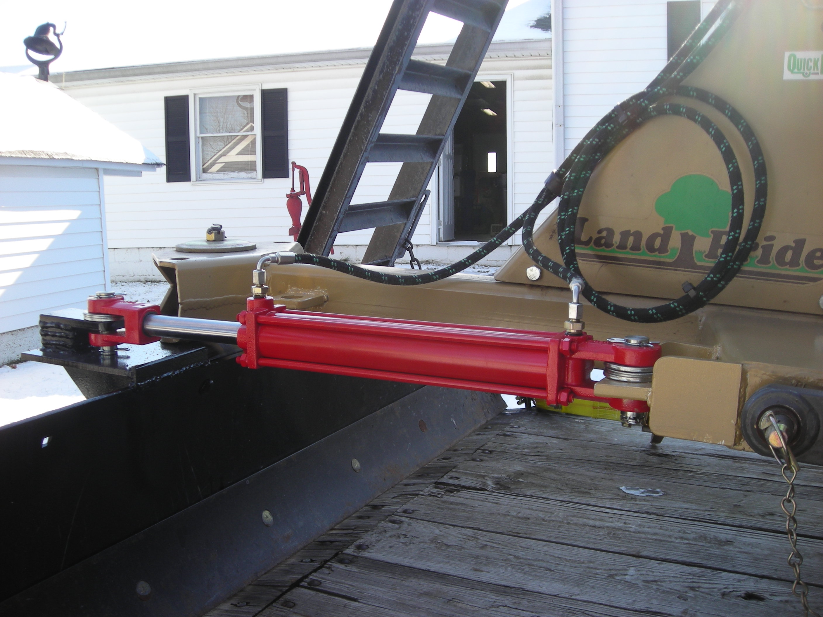

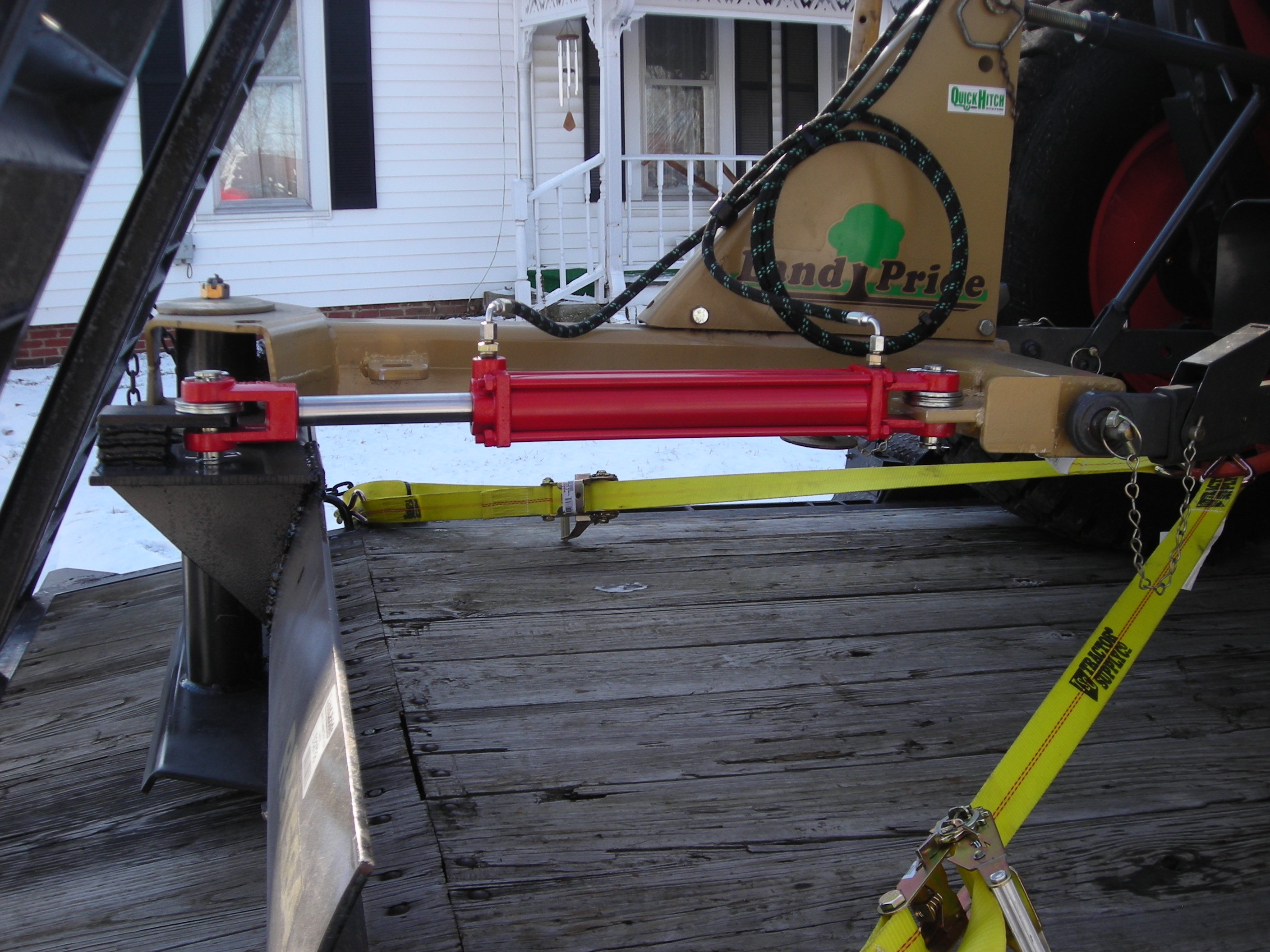

Here are some ideas for hydraulics. Philip.

Thanks Philip, but I eventually want all three functions(offset, tilt, and angle) to hydraulic. My driveway is #1 purpose for tractor.
