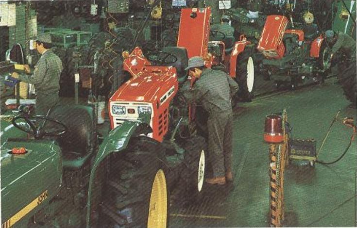

A JD850 is really a Yanmar YM2500, just in Deere green paint.
97% of the parts of a YM2500 work and fit on your JD850. They were both made in the same Yanmar factory in Japan.
