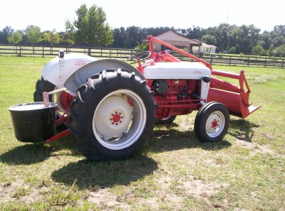

If the 3pt lifts it.. it's probably ok as a static load. "break in halves' are generally dynamic loads.. like 3pt backhoes..
Here's my 51 year old ford 660 with a 1-arm front end laoder rated to lift 1000# toting 600# or so of concrete as a counterweight on the rear..... I think you will be fine..
