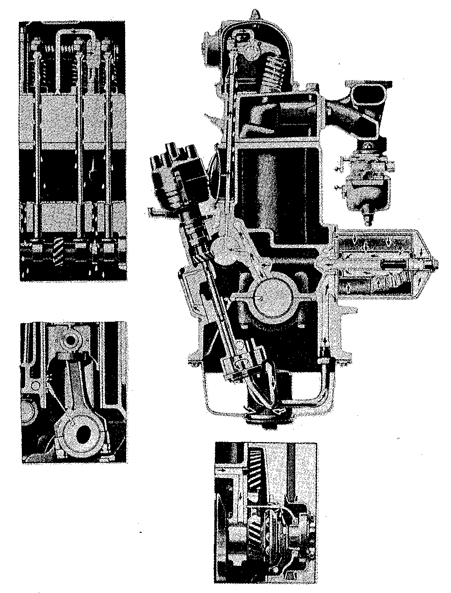

My 850 started running very poorly. I found no compression in cylinder 4. Taking off the valve cover, I noticed that the intake valve pushrod end was not properly seated on the rocker arm, and was hung up just pushing on the outer edge of the depression. The valve still went up and down as I turned the engine, but because the pushrod wasn't seated all the way, the intake valve did not close. I was able to snap the rod back into the seat on the rocker by hand. That allowed the valve to operate normally, and compression was restored.
My questions are how could this happen? What do I need to look at further to see what is going on? Do I need to take off the head? I am not able to find an exploded diagram of the engine online. There was one that I had bookmarked, but it seems that website has now changed and it's gone. I am not a very experienced engine mechanic, but I keep my stuff running. This is my first encounter with the innerds of this particular engine. Thanks for any advice.
   / 850 pushrod problem #2
I can think of a couple of things that could cause it but best bet is you have a sticky valve. I would pop the valve cover and verify the valve clearance is correct and give it a good cleaning.
