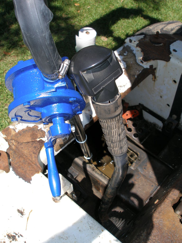

Oh, by the way, on your hydraulic leak. That's a lot in two hours. Unless it's an obvious leak you can see (and you say you can') you really need to pressure wash the heck out of the inside mess you have in there. Bet you'll find it then. Plus you'll have a cleaner area to work on. Also, do the pressure washing BEFORE you do your chain case covers cause if that was the leak problem there, you get more water in the case. Then you'll only have to change that oil one time.
This is a picture of the chain case opening between your feet that I was putting a new gasket on.
Also how I emptied the oil out of it with a hand pump.
Hi thanks for the info.. yes I seen the word (engine) stated in the manual I just did not want to believe it . I really didn't catch it until I was adding it here to the forum post.So yea i am sure my engine would also need to be pulled.
I did add a silicone gasket to the center plate 6 months ago still getting water in the case. Ill start checking every thing now. I just got done pressure washing it. That sure did make a difference.
