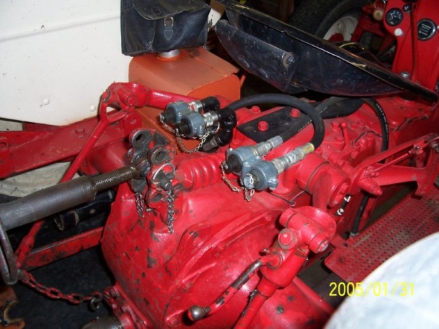

Are their any 8n Ford tractor buff's on this vintage tractor forum? My old 8N has been with me for 30 plus years. It has several modifications. I'd be interested in hearing from anyone who still uses and or loves the good old 8N. Please see attachment. Yugo

I been using them since 79. Rebuilt several from the ground up, Yours looks in good shape. I see you have added power assist steering and upgraded the oil filter and Alt. What's the hyd's near the rear axle?

I love and collect fords. That a power steering conversion from jackson PS?
How do you like the spin on adapter? That a 51 or 52?

Soundguy - I'm very impressed with your knowledge on Ford tractors. I enjoy reading your posts. But, 8N Ford stopped in 1951, and changed to overhead valve motors in 1952. Am I wrong? The power steering is a home brew - a hydrostat steering motor with a GM 70 - 80 power steering pump feeding it. No steering box anymore. If anyone is interested, we'll try to show a few more pictures of it. Works great. One fingered steering! Thanks again, Soundguy for all your posts. Yugo

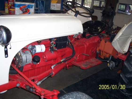

Soundguy : you are right ,had to get the book out,1952 8n,s.
mine is a s/n 8n282483 with a side mount dist. yugo

More pictures of the hydraulic system on your 8N would be great. Where is the pump?

jgbansee - The pump is below the tank and valves. It's driven by a electric starter motor. (sort of like the small truck's snow blades) It's not the best, but it does work well with small cylinders. We do have the mast and forks assembly mounted on the 3 point. It's a 2 stage, 2000 lb lift capacity. It goes about 12 feet high. It's a little more than the Ford really likes - must be very careful. Please see attachment. Yugo
