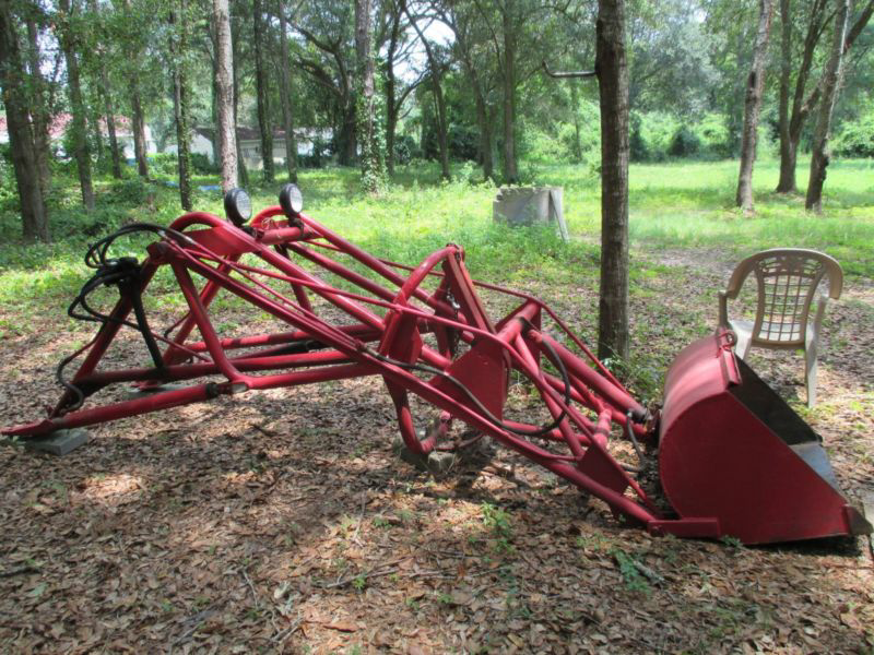

How crazy would it be to try to modify this "factory" loader taken off an 8n to fit an L285? I know it would take a lot of cutting and welding, but as a rough starting point. Let's say I can pick this loader up for $250, would you consider it. It has 3 hydraulic cylinders (probably single acting?) hoses, valves, and at least a starting point to make the loader arms and bucket.
I'm not sure if I could get it that cheap, and it's about 100 miles away, and I'm not sure if I could convince wife to let me buy it,

Keep in mind, the old 8N loaders were mainly intended to move animal manure. Not strong enough to dig.
   / 8n loader on a Kubota L285? #3
And no down pressure with single acting, which it almost assuredly has.
If you are capable & want a project to entertain yourself (I have a few similar lined up) go for it, but don't expect much of a return on investment if you end up selling it.

It ended up selling for $550, and no way I would give that.
