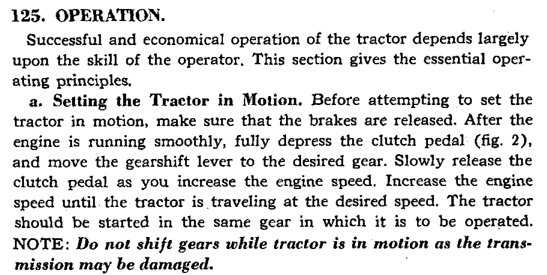

Is it ok to shift gears, like 1st to 3rd, when moving? Pulling away in 3rd when towing or carrying an implement seems a strain on the clutch (longevity wise)

Most every one, including the owners manual will tell you DO NOT shift while moving.
They say the clutch is designed to be slipped and handle the abuse.
But I do know how you feel.
I have successfully shifted gears on my 3000's 8 speed while moving (trying to match everyone's speed in a parade) without grinding gears, but it takes timing, clutch and throttle control.

Well, the owner's manual will tell you to NOT do it. But, you will always hear from folks who say they can and do do it. If you mess up, it could be an expensive mistake.

Can it be done, yes, should it be done, no. Have I done it, many times... Doing it you risk the chance of damaging the gears gears in the transmission, something the is WAY MORE expensive than a $200 clutch.
Bottom line, don't worry about it, a little slipping to take off is not going to harm the clutch, you'll be more likely to cause clutch problems if you ride the clutch, meaning letting you foot rest on the clutch pedal.

I went through shifter problems. No Rev. when I bought it. Clutch/P.Plate and Shifter. Weak brakes with a a good bit of weight in the FEL.. I broke Rev. barely moving while shifting 1st. to 4th.. Heard it grind and went in all 4 forward but found out no Rev.. The brakes was pitiful so I didn't try to stop all the way with a load. I did it and know how. Had to cut a couple trees when I found out I was stuck!! Replaced them this time and I'll be stopped dead before shifting again! My ford Manual plainly notes " Do Not Shift Gears WHILE Tractor is in Motion" :rolleyes:
