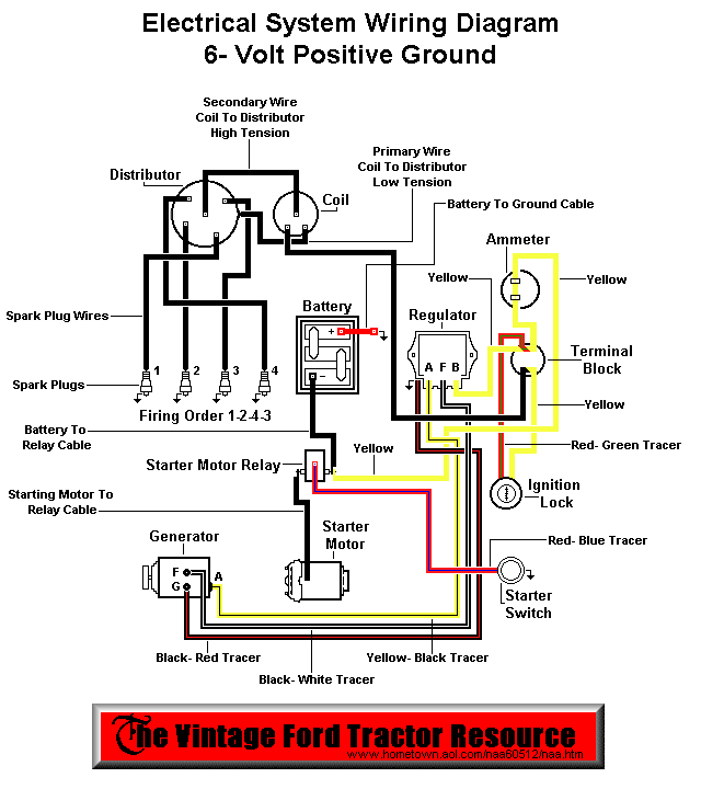

I'm on day 3 of trying to get spark going on my '52 8N with a side mount distrubutor. It is all stock 6V components. I've searched and read up on everything but nothing seems to work. Was hoping someone might have some ideas here.

Then I grabbed my multimeter. Verified I have 6 volts going into the coil. When I check the voltage from the battery side of the coil to the points arm I also have 6 volts. So I know I got 6 volts into the distributor.

I have attached a wiring diagram I located. My suggestion is to check for continuity on the wires. My guess is you have a broken wire somewhere.
Wiring issues can be frustrating. Good luck!

chriscos,
Verify you have a rotary button and it is turning when the engine cranks. You might try plugging a spark plug wire directly into the coil tower and plug the other end onto a grounded spark plug. Then, with the switch on, every time you open the points you should see a spark in the plug.
With the points open and the key switch on, you should read 6 volts to ground on both low voltage terminals of the coil. This proves the coil has continuity. With the key switch on and points closed, coil bat. terminal should have 6 volts and the other should have 0 volts. In fact, you should read 6 volts across the coil. This proves there is current flowing through the coil. If current is flowing and you open the points, you should get a spark. As for seeing a spark on the points, you should see little or no spark if the condenser is good.

Thanks all for the suggestions. Turns out it was a short where the wire from the coil comes into the side of the distributor. There is an insulator inside that was disintegrating. I jury rigged a piece of cardboard to act as an insulator and verified that is where the problem was. I have spark on all plugs now.
   / 8N Side Mount, No Spark #7
plastic license plate insert grommet works good there.. ort a wire run in and pushed to the side to stay out of the advance.. and a dab of rtv.. etc..
