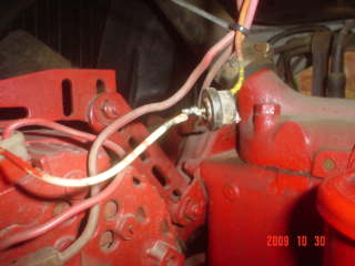

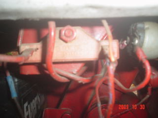

I have some kind of porcelain terminal I took a picture of, what does it do?
I also have a picture of what looks like a diode on a wire to the 12-volt alternator?
(I took the electrical tape off just for the picture.)

The picture on the right is a resistor. Take it loose and flip it over any you should see a coil of wire. This is typically used when you are running a 12v battery with 6v distributor electrics (coil and condenser).

yes the porcelain thing is a ressitor.. and I can't make out the small pic well for the alternator.. but it is common to have an isolation diode in line to the #1 excite terminal on a gm alternator.

I checked the reisister and its burn into.
Did I burn it up with the hot wire or is there a short somewhere or was that the problem?
What are my options for replacing the risister, do I get another one just like this one or is there something better to replace it with?
Where is a place to get a new resister?

replace the resistor.. it is 'open'. no.. a short didn't likely kill it.. nor your hot wire.. in fact.. you hot waire was an artificial short circuit taking the resistor side of the circuit out of circuit so to speak.. IE.. a bypass.. since the origin of that circuit is the bat hot anyway.. there is NO WAY for a backflow of current if it's wired correctly.
just replace it and then check it out again.. I still suspect the ignition switch.
try this.. jump from one side o fthe ressitor tot he other.. will she start? yes.. then just repalce the resistor..
no, then jump from in front of switch ( power side ) to past broken resistor... she start? yes.. then repalce switch and resistor.
no.. then keep following the wires back till you find the bad connection betweenthe battery and start switch..
Now here's some even better advice.
ditch the resistor an old 6v coil and hit a napa and ask for a IC14SB it's about a 16$ REAL NATIVE 12v coil.. needs no resistor.. has NO internal ressitor.. it's primary is simply sufficient gauge and # of turns to be 3+ ohms.
get that coil, and the new switch if needed and you should be set.
new coil costs perhaps 8-10$ more than the resistor.. but is a better deal.. old coil is not oil potted.. new coil is.. that's way better thermal disipation properties.
