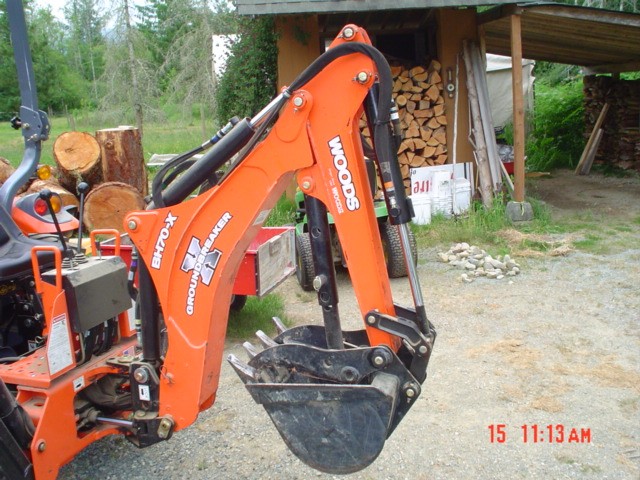

I have a 16 inch bucket on my backhoe. One of the concerns with that small a bucket is that, depending on the type of soil, often it is very hard to get the clay, wet dirt out of a small bucket like a 9". In gravel or dry dirt it should work fine. Just a couple of days ago a dug a small drainage ditch of about 30 ft and found all the dirt/clay was not getting dumped out my 16 inch, hate to think if it was only 9 inch.. It has been wet in our area and so the ground had a lot of moisture in it. Hope this helps in your decision making.
