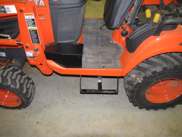

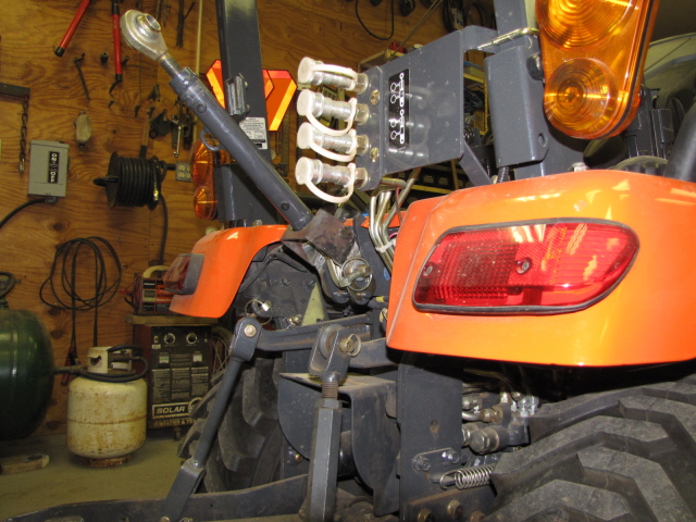

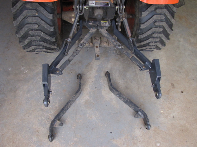

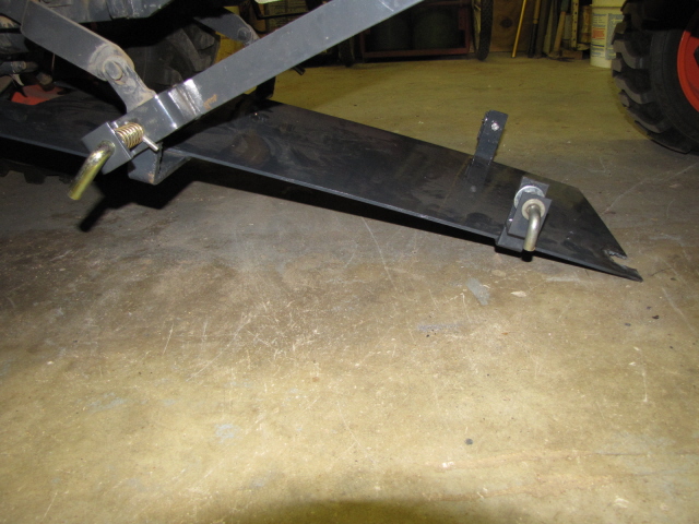

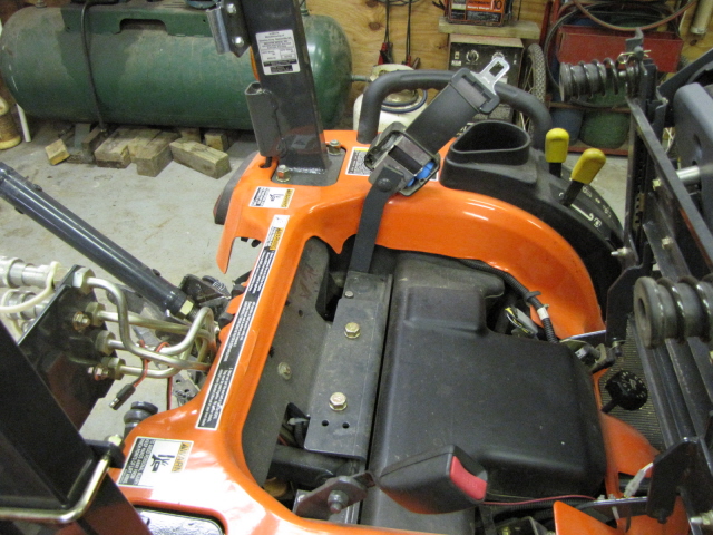

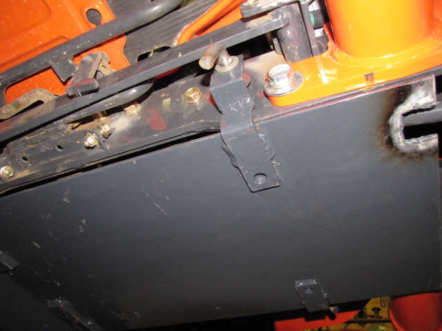

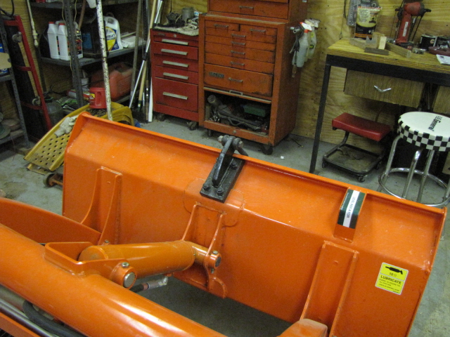

These are the upgrades or customiza I have done to my BX. You might of seen some of them before, but I thought I would put them into one post.

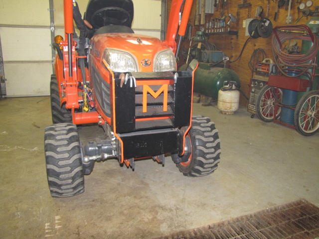

#1 is the bracket for useing chains and a small boom pole.
#2 & 3 are the front bumper with chain holders.

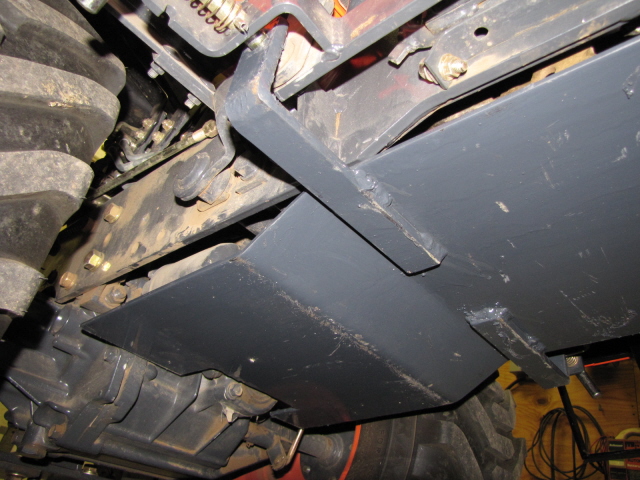

#4, 5, 6, & 7 is the skid plate and how it hooks up,( with 4 pins ).
#8 is the tool box and the step that uses 1 bolt to hold it on.
#9 is of the seat belts that I moved so I didn't have to unhook the seat to rase.

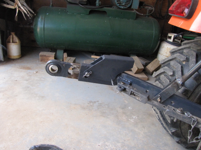

#10 You can see the draw bar, the adjustable lower links, and the bracket that I changed to get ready for the hyd. top link.
#11 is a different picture of the bracket for the hyd top link

I like the grill guard, it gave me some ideals.
In the 1st picture is that a long chain shakle thats attached to the center cat eye that you bolted on? thanks for the the pictures.:thumbsup:

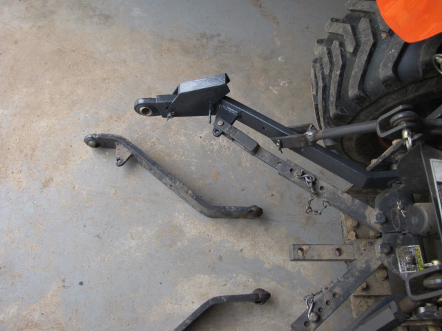

Did you make those adjustable lower links? I like them! :thumbsup:
   / 9 upgrades to my BX2660
moored4, yes that is a shackle.
magicheater, Yes I made them.
   / 9 upgrades to my BX2660 #5
I like the lower links a lot. Getting very tired of twisting the turnbuckles on the factory system.
Is there any reason to think that there will be un-wanted sway in an implement since they are not as adjustable as the turnbuckles?
There has to be a little sway, but not much. Not enough that would be any problem at all. I think I have one set of holes 3/4" on center and the matching set @ 1" center, so that should give me 1/4" adjustment. Or maybe 1" and 1 1/4" not real sure, but anyway they are 1/4" differents.
Some guys like the turnbuckles, but they are not for me. That was the 1st thing I done when I got it.

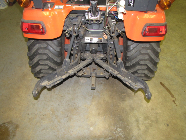

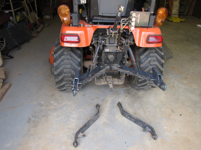

#9
I'll try this again, might end up with 2 post.
I have working on a good way of making adjustable lower links for awhile. So the other day I just jumped in and done it. They ended up 3 1/2" longer, but that is OK with me. I also had my brother cut some wheel spacers and put them on. They are 1 3/4" wide. I guess that would be #10 and 11.
I didn't order the hyd top link and sure glad I didn't. After the hyd top link I hope I'll be done with it.

   / 9 upgrades to my BX2660 #10
I love telescopic lower links. I got some for my Yanmar and that extra 4" of length lifts my attachments high enough to actually set them on a trailer. :cool: They also are very useful when I hook up to my PHD since they can easily extend and allow easy installation. :thumbsup: I really like the Mods you did to your BX, especially the skid plate that drops down. Very cool! :thumbsup:
