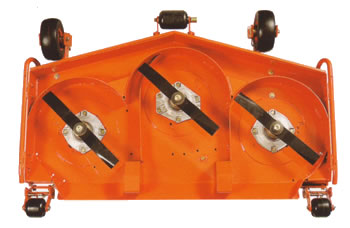

I think I've read somewhere that some people have cut off a portion of the rear of the deck to get the grass out quicker. Maybe like 1 1/2" off the back lower most lip ? I wanna know if this is worth doing..what the results were..and if you were happy with it. Sounds like it might work better. Thanks.

I purchased a 72" 914 A rear discharge in 2007, I was not happy with the discharge of the grass so I cut off about 1 1/4" off of the tail deflector. That made a noticeable improvement, but in tall grass it would fill up underneath and bog down so I cut out the back half of the center baffle and removed more of the tapered back sections on the left and right baffles. Now I can mow 10" to 12" grass with no problems. The last improvement was gator blades from New Holland about $70 at the time. I beleive that the deck is not tall enough for good airflow, I think the design of the tractor limits this deminision. I am happy with this mower, much easier to mow with than the side discharge that I sold. I am trying to attach a picture of Kubota's rear discharge mower, the small inner baffle I would like to add to my center blade to see if there is any improvment.
