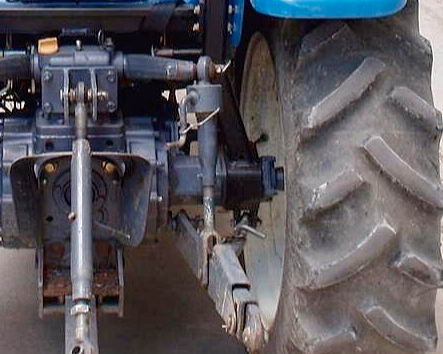

Hey everyone, I am new to the forum. I just purchased a 2001 TC33D that has a 72" 914A MMM. I mowed about 1.5 acres yesterday with no issue. Today I started mowing and immediately shredded a belt. I guess my first question is where is the best place to get a replacement belt. Secondly, when I raise the 3 point all the way up, the right side of the mower deck is about 1.5" higher then the left. I tried adjusting the bolt that sticks out the back with the blue spring, but that did nothing. Is there some sort of adjustment so it comes up level? Finally, does anyone have a digital copy of the manual for this deck? Sorry for all the questions right away, this site is great.

Jason, the handcrank above the right lift arm is used to level implements side-to-side. Use the adjustable toplink to level the implements front-to-back. Both are shown in this photo. The left lift arm has no adjustment, only the right arm has the handcrank. It will move that arm up-down about 6". Oh yes, set the implement on the ground to make adjustments. When the arm is under tension, it is a "bear" to operate the handcrank. Also, the handcrank has two grease zerks that need a shot of grease every now and then to keep the crank working smoothly.

First make sure all your tires are at the right tire pressure. Tire pressure will affect mower heigth, especially with turf tires. For mower deck set-up, first level your 3pt arms measuring to the ground, adjusting the crank on the one arm. If the deck leans one way, the adjustment is the bolts in the rear with the spring. There should be 2 nuts on each to lock together. When lifted all the way up, you should be able to install the clevis pins in the rear deck lift arms to lock the deck in the high position. If it is too high or low, adjust. If you would ever need to adjust the deck front to rear, that adjustment is done on the front lift arm rod that is between the front and rear deck lift arms. My mower deck manual is #86592324
