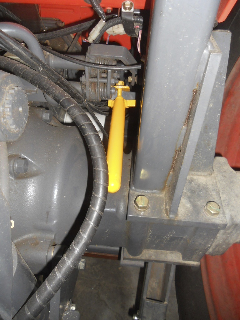

I've been wanting to do this for a while. Hooking up when you can't reach the lever from the back or over the tire to adjust the 3 pt height, even with telescoping links can some times just not go well. The little yellow handle is basically clamped around part of the mechanism already there with a small u bolt welded to the handle. Not much to get a pic of, and it's hard to see but you'll get the idea. The upper horizontal shaft is for the draft setting lever and the lower is for the 3 pt position, both are part of the factory linkage.

Great Idea. I will add that my mine. Thanks for sharing.
   / 9540 Kub rear control for 3 pt #3
Nice work Eric!!!! I like the bright color. Makes it easy to find when needed!!!!
