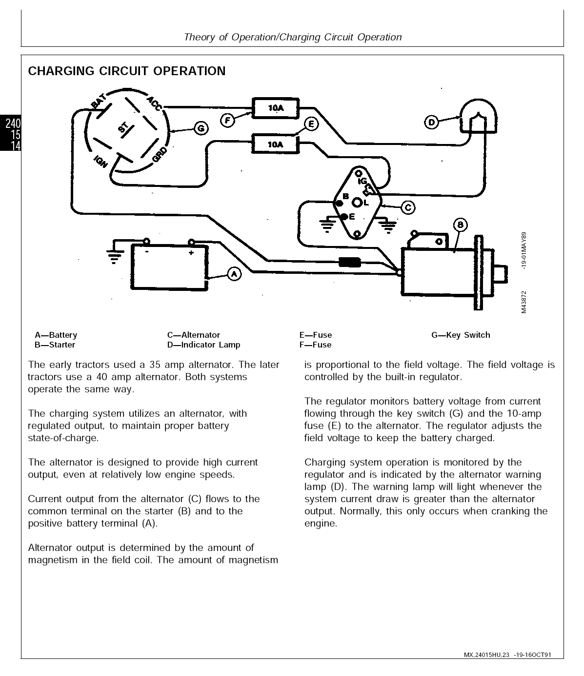

2- The VR is shot and has an internal short that is not repairable. Both Yanmar and John Deere have a Technical Service Bulletin out for over 2-1/2 decades that address this. Get the newer style solid state VR.

Test continuity between terminals. You'll need the TM1360 JD Service Manual to follow the procedure.
TM1360, Section 240, Group 10 covers all the needed info you will need. :)
In Group 15, there is a cheesy hand drawn Charging Circuit. The entire SM is really detail until getting to this page, like it was an afterthought. LOL
