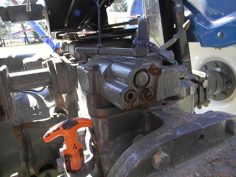

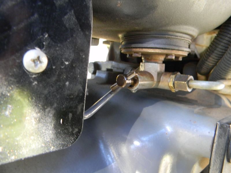

Anybody ever had a fuel shut-off valve under the tank leak? The parts diagram shows an o ring. On the hydraulic shifter under the seat is there anyway to adjust it to keep it from jumping out of position? It switches the hydraulics from the bucket to the rear lift. I have to use a bungee cord to keep mine where I want it. I'll post some photos.

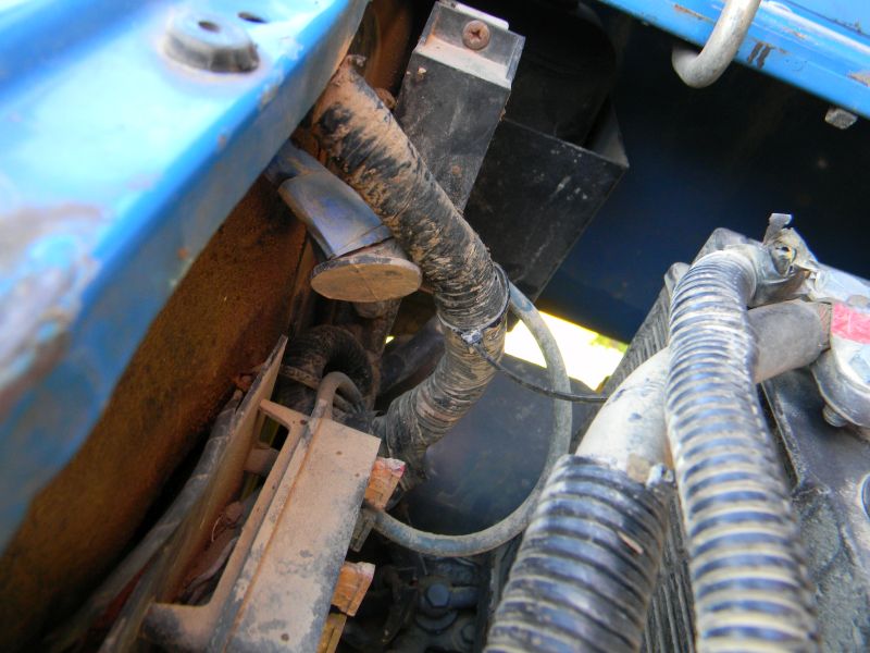

Also if you are having charging problems check the battery sensor under the battery swing out tray. Mine had a wire broke off. It won't charge is the wire is broke or bad sensor. i just cut into the rubber on the sensor enough to solder the wire back. I then just tied it back to the firewall.
