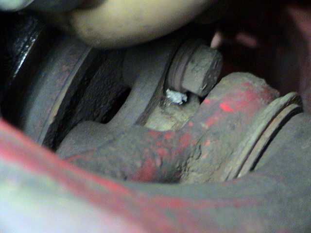

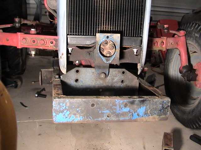

MY 8N had a front mount pump, and as the others say, it runs all the time, a PTO one would not. As far as a bracket? Mine mounted right where the axle pivits. Here are some pictures........

another........

Where pump shaft mounts to front pully...............
