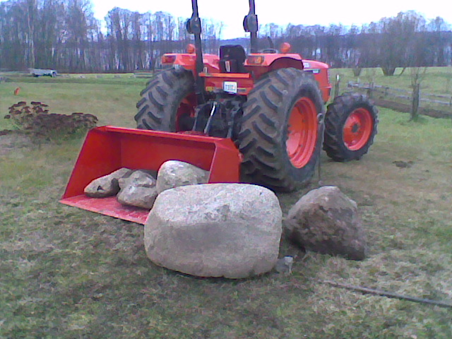

First of all, you need NOTHING TO MODIFY ON YOUR TRACTOR. It operates perfectly. Each modification may lead you to the big trouble!!!
If you can find hydro specs of your tractor (Operators Manual), you will read exact digit of lifting capacity of the rods at the ball points. The attachment is always further from the balls, that means the further the load, the lighter it must be. Yes, as you and other TBN'ers mentioned, if directly connected tiller is being lifted easily, it may be, that the forks+pallet+tiller+additional-lever-arm is too much for your tractor.
This phenomenon I meet every time, while working with 3ph bucket. The buzzing reduction valve always informs me when the load is too heavy. Like you, I can't load the bucket at full desired rating in my case of gravel or stones. And that is normal.
So there is no mystery ...
