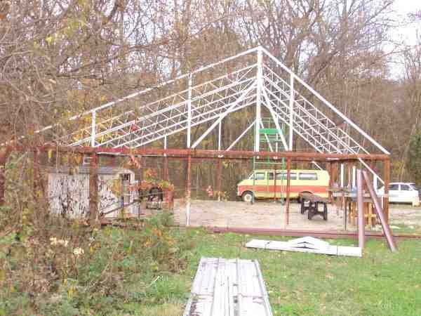

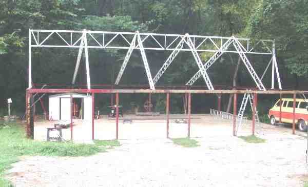

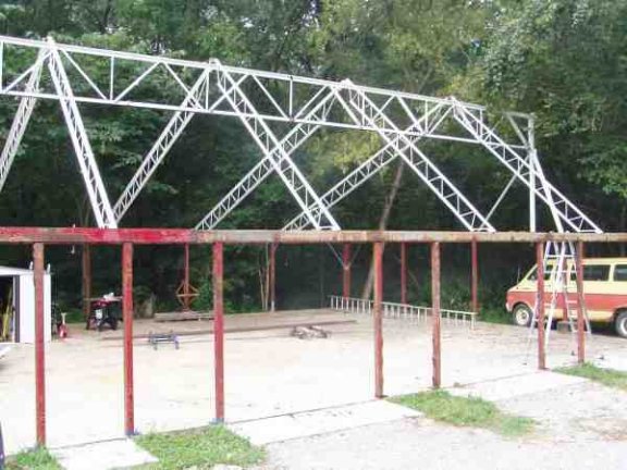

What do you all think about this guys method- Used a Long steel bar joist at the peak of his building? I like it and am considering using it since I can get a salvaged 44 to 50 ft joist locally for cheap.

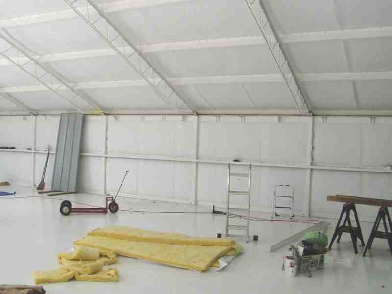

inside pic

You won't have to worry about termites!
How is it cost wise for the snow load you need?

No snow here, But I will use a much shallower roof pitch to catch less wind and a bunch of 8 inch purlins from the center joist to the walls. Then 2 by 4s every 4 feet cross ways on top of the purlins, then foam insulation board and then the steel roofing.
