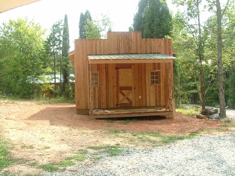

I have been keeping the tractor under the front of my shop and it is always in the way, so I knew I needed a tractor shed. Vickie has been wanting an old building like an old store or a saloon so she could decorate it to fit our place so I killed 2 birds with one stone.
I made it by laminating some ground treated 2x4's together, one at 4ft then 6 ft, then one 5ft. They are much easier to handle and plumb and square than 14' 4 x 6's. The building is 16' wide by 24' long. The front has a door and 2 windows that lead into an 8' x 16' room that will be storage for home remodling parts that are always left over on a job that currently take up space in my shop. I started looking last week and I have 11 galons of paint in 1 gal cans and 3 5 gal cans of paint, a box of new door knobs some trim moulding, sheetrock dope and tape ect.
Now I will have a place for that stuff and can keep the tractor and mower out from my shop. I thought you would like some pics of it. Here is the front which is seen from my front porch, Later, Nat

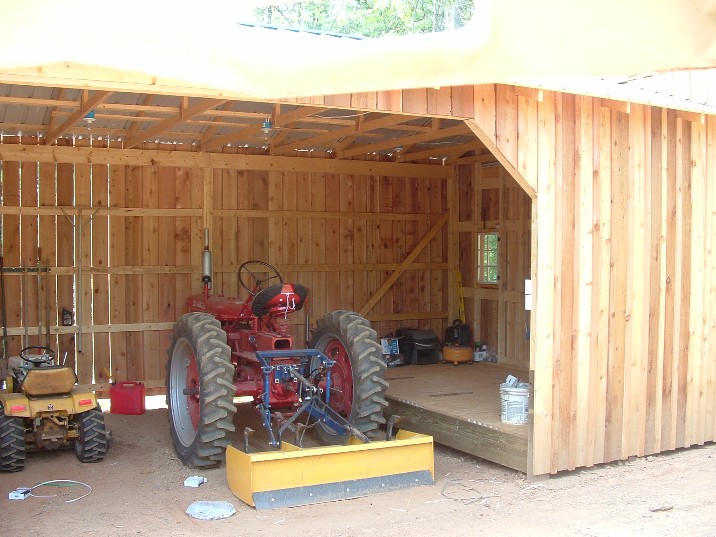

Here it is from the side where I put the tractor

Here is a look in the tractor shed

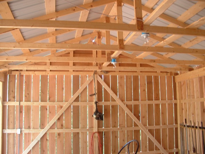

You can see that I havn't finnished the wall between the shed and the storage room in that last pic. Here is how I framed the walls and roof. A fter planting the laminated ground contact part of the post I leveled all the way around, man, a lazer transit sure is a nice tool to have. I measured up from the level line to the top of each piece of the laminated post and subtracted that from 10'6" so I knew how long to cut the 2x4's that made up the post. I then ran a tripled 2x10 around on the top of the post flush with the outside. I fabbed up the trusses in the shop on a 4 x 10 table and stacked them up on the truck. I backed the truck into the shed and sat one end od the truss on the triple 2 x 10's and carried the other end up a step ladder. It only took 1 day to fab the trusses and install them and the skip sheating. I ran 2 x 4's around between the post to hang the siding on. Here is a pic from the inside to show the framing.
