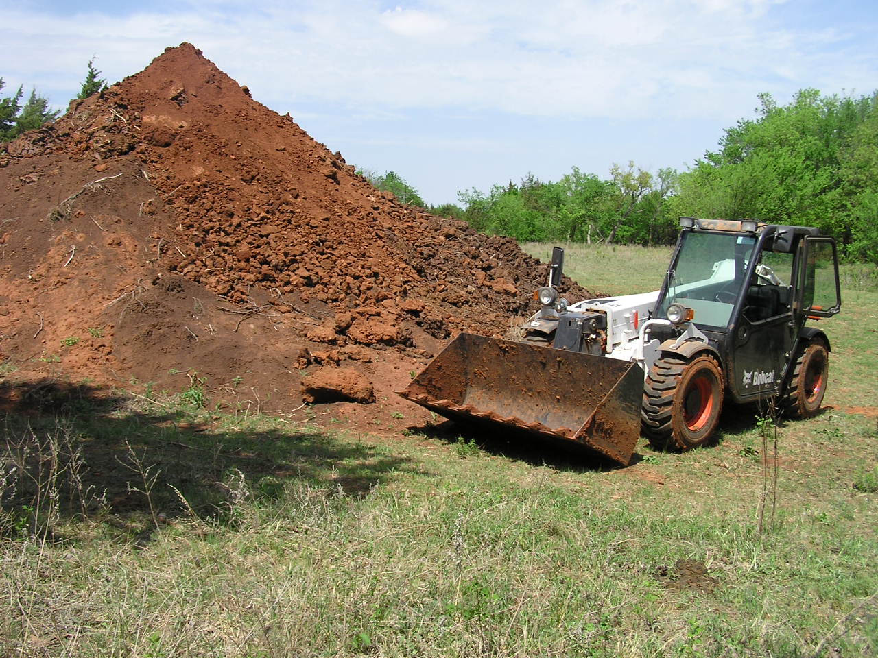

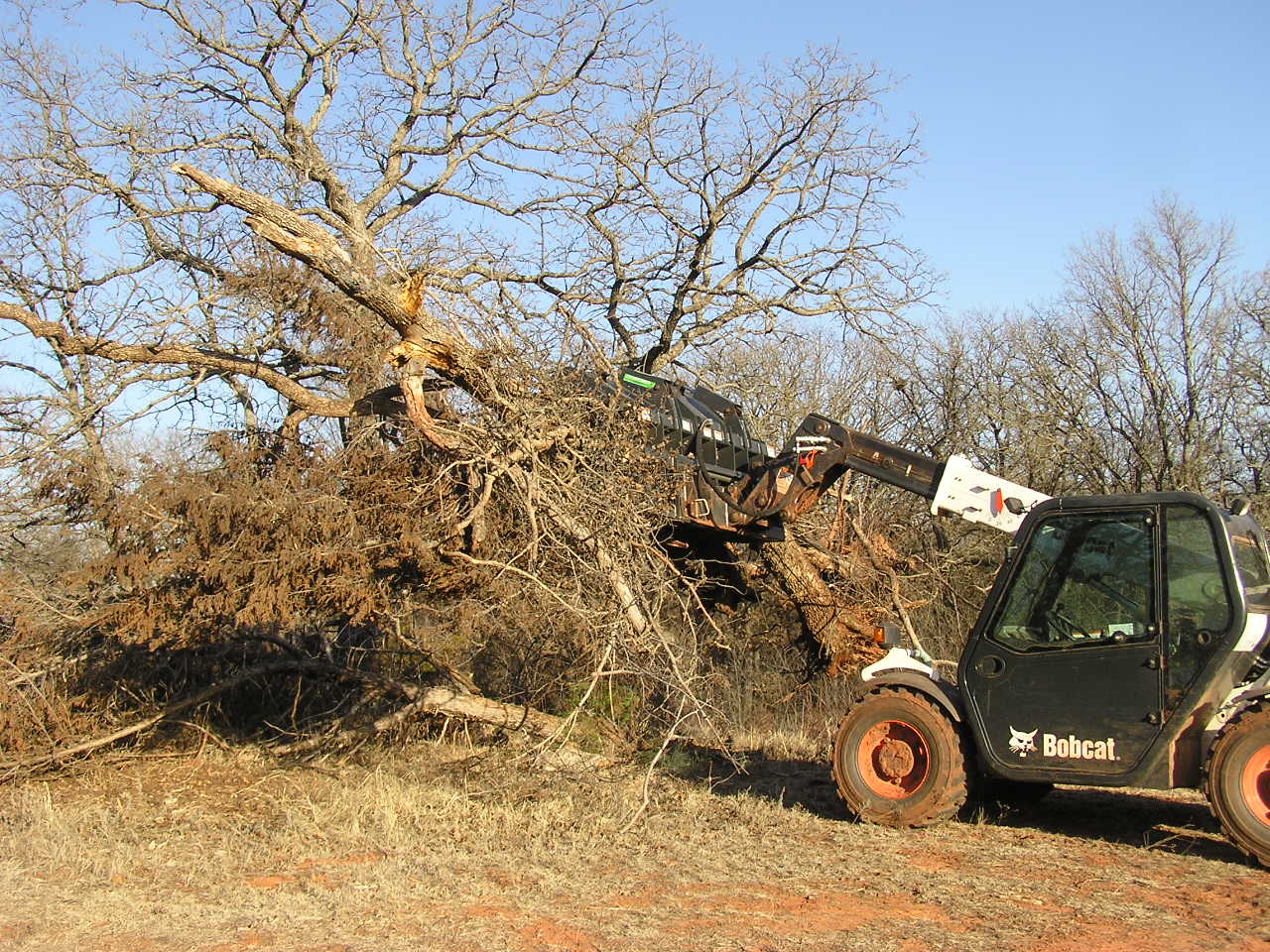

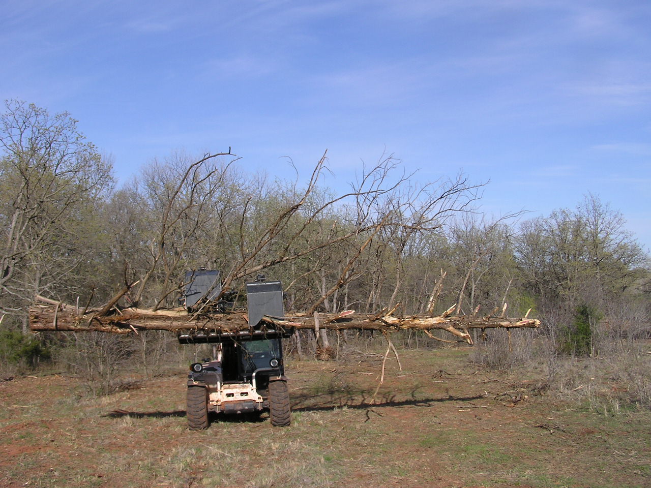

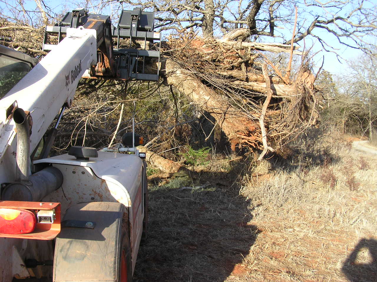

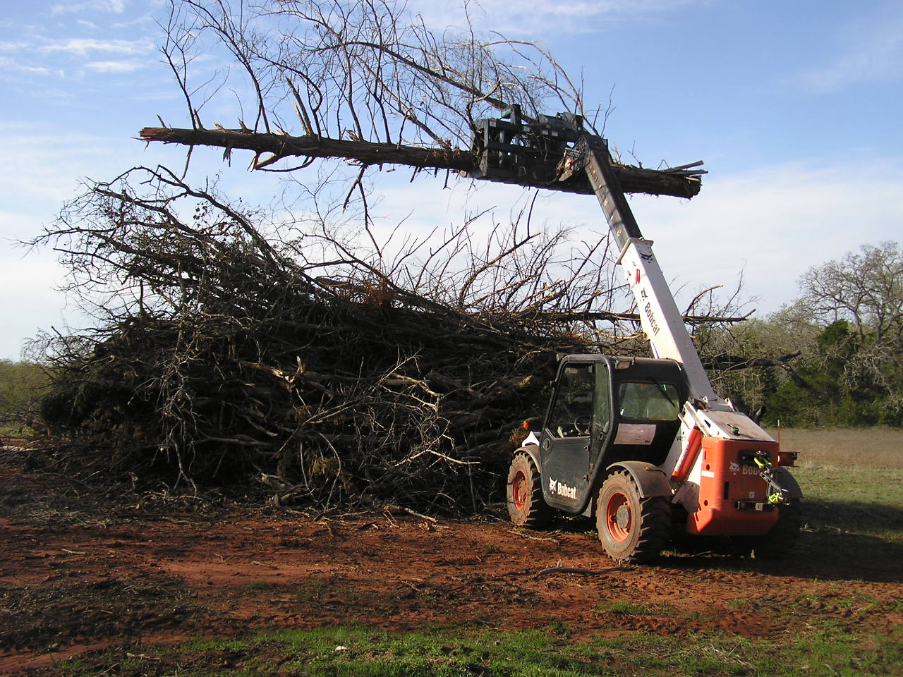

Mooch, have you considered a compact telehandler?
There are several brands available with a SSQA attachment plate. Mine has a top speed of 15 mph, cab with heat and A/C.
It will move some dirt!
:thumbsup:
More info in this thread: http://www.tractorbynet.com/forums/bobcat-construction-equipment/160568-compact-telehandler.html
