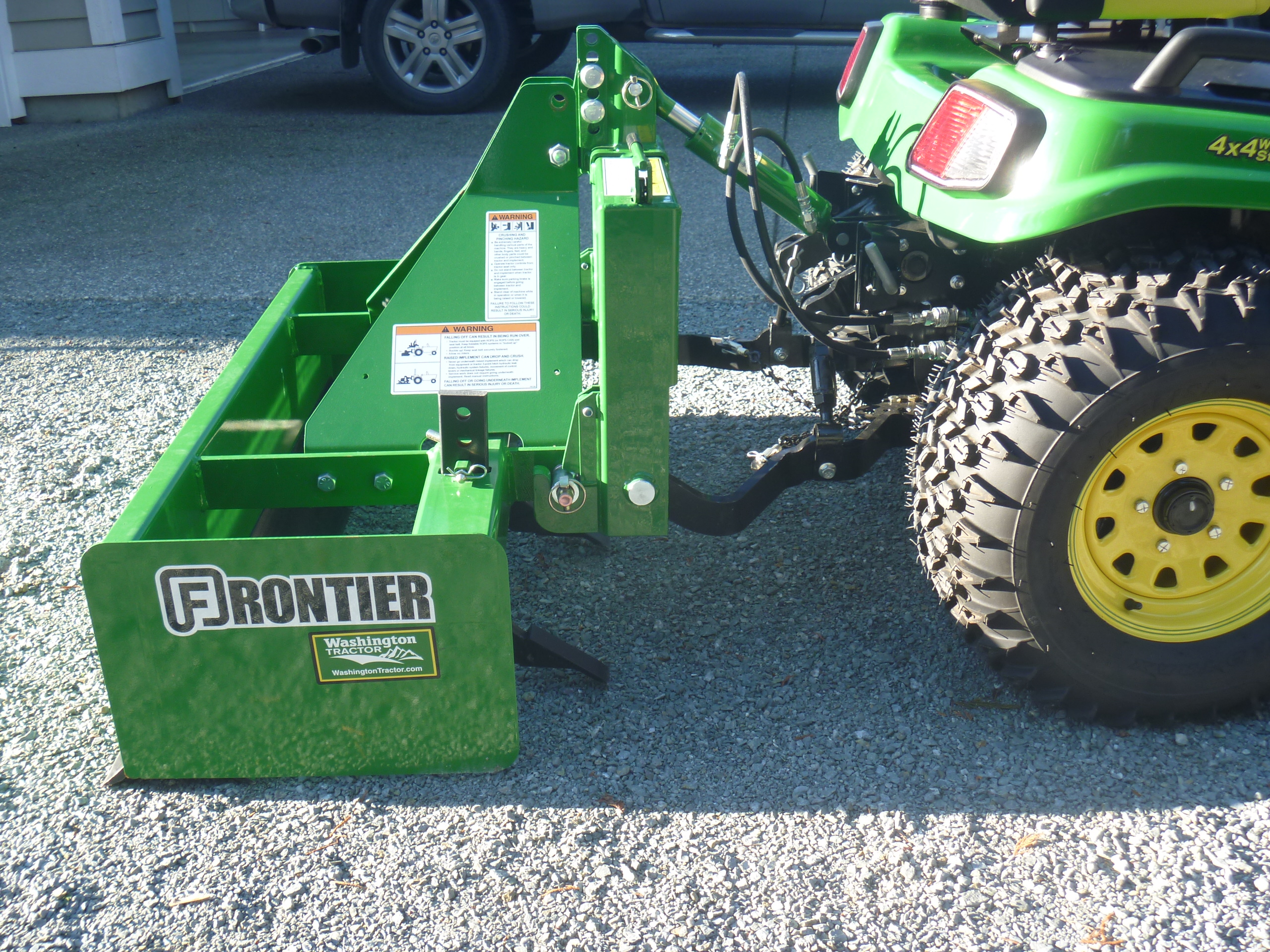

I've had a X739 which has all wheel drive and 4 wheel steer for 6 years now. The rear transaxle is connected to the motor by a drive shaft. The stock setup is a front facing PTO on the transaxle that drives the mower deck with a drive shaft but can also be used for optional shaft driven implements on the front of the tractor (snow blower, broom). A rear facing PTO on the transaxle is optional for about a $1,000 that can be used for 3pt tillers, cutters etc. An optional 3pt hitch ($600) would be required to use those implements. The front wheels are full time hydraulically driven and work great on all surfaces, I normally plow snow without weights or chains. The mower deck has one belt that drives the 3 blades from the deck gearbox and the motor has one belt that drives a fan to cool the radiator, thats it for belts!

Zero issues with the hydraulics, I even added a set of rear outlets for a 3pt hydraulic top link. I had a JD 318 for 26 years and the hydraulics on it were rock solid as well.
The only problem I've had with the X739 was a small coolant leak on the intake manifold gasket which was covered by my extended warranty. It was only a few drops a week and I probably would have lived with it if it hadn't been covered.
