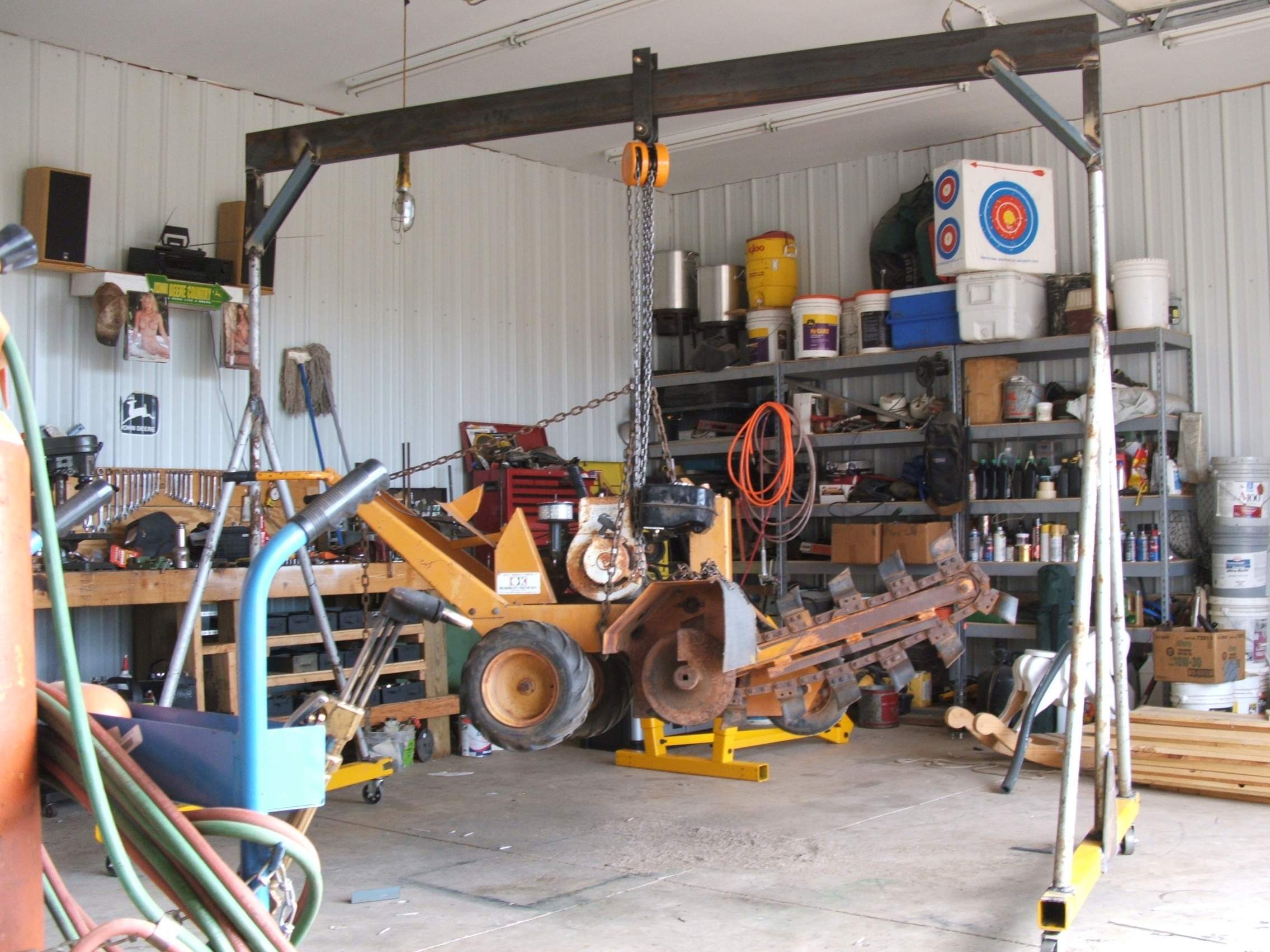

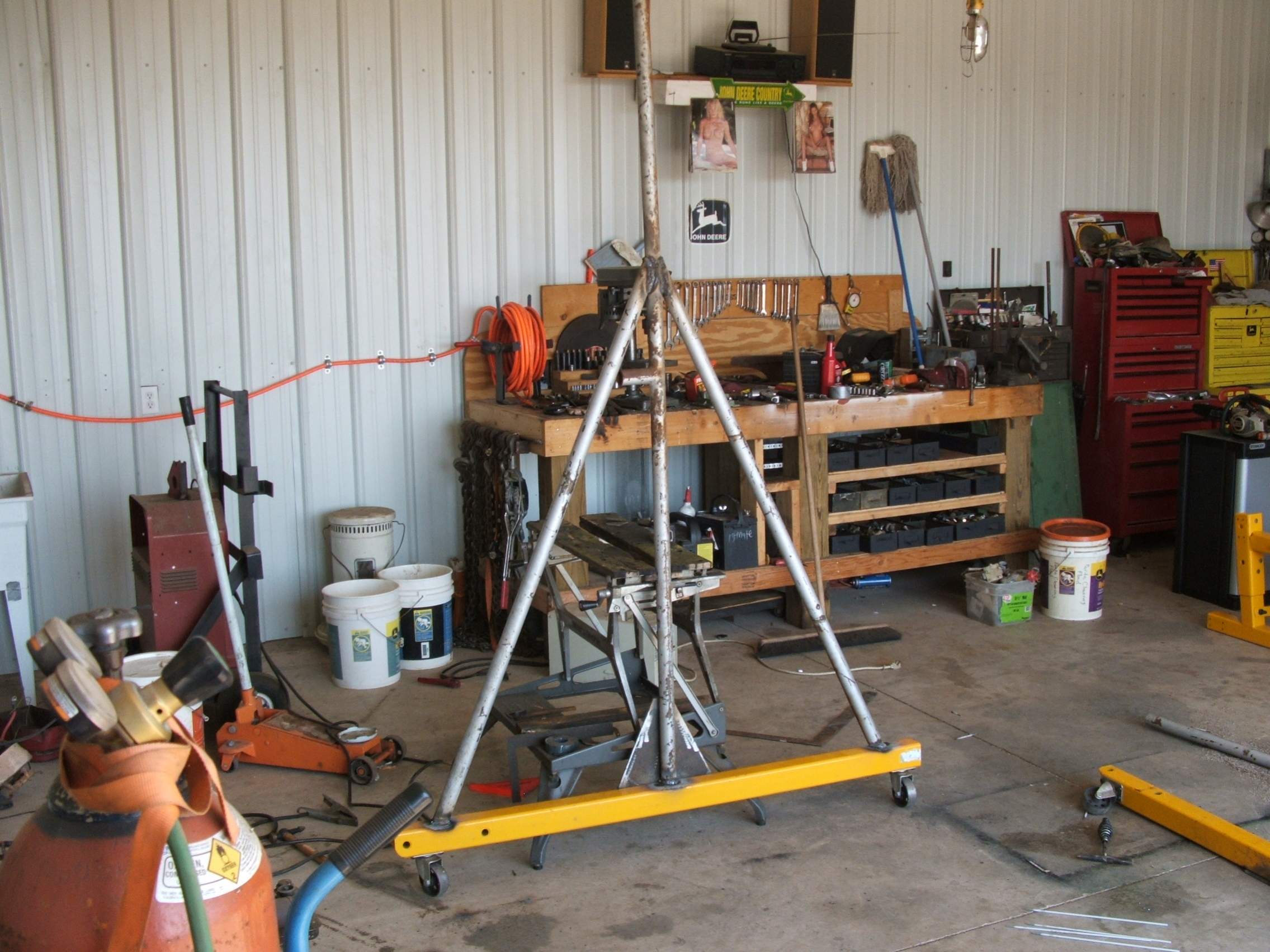

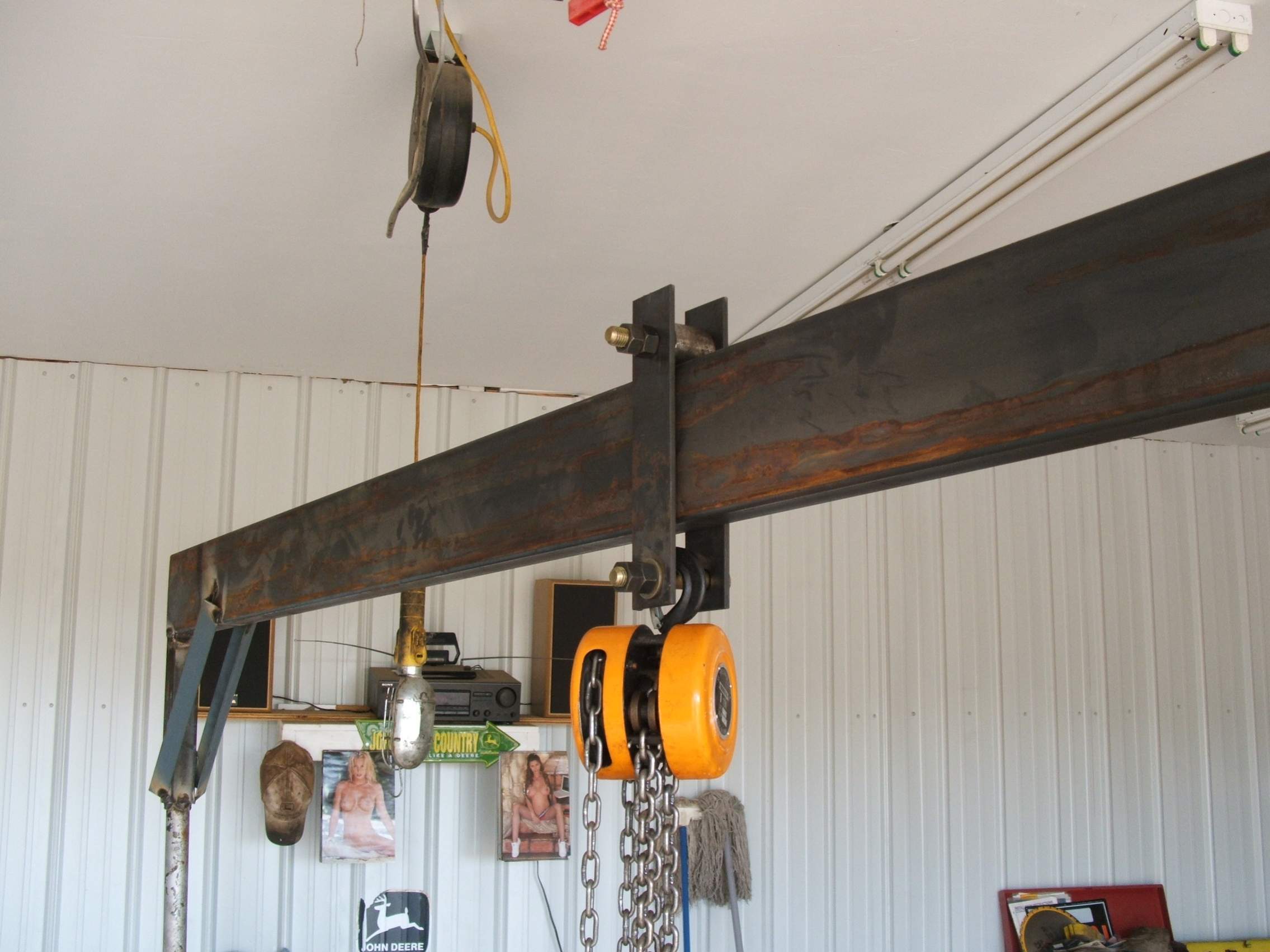

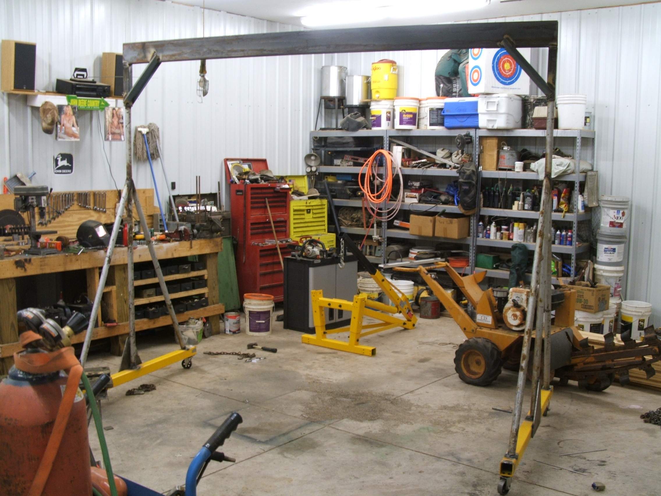

So I just finished my A-Frame. I bought a cherry picker about a yr. ago and did not like it. Cause the supporting legs to the front of it are about the same width as lawn tractor wheels. That makes it hard to get underneath the tractor and be able to lift straight up. Since most of my work is lite, but still heavy when pulling lawn tractor engines. I needed something that would help assist in removing the engines or whatever else I needed to do. So here it is. I used mostly scrap metal I had laying around. I did use the front supporting legs off the cherry picker and had to buy a top beam. Man the price of metal is out of site. Twenty foot stick is the only way they sell metal around these parts. I used a 2"X6"X11ga. retangular tubing for the top beam. I was going to use a 3"X5" I-Beam but they wanted 200 dollars for that so I settled for the rectangular tubing instead for only 92 dollars. It seems to work great, as you can see from the trecher I just purchased. It ways prolly around 600 - 800 lbs. and is about 2 feet off the ground supported by the A-Frame. Hope yall like.

Some ones going to get hurt with that thing, like the photos in background tho!!
   / A Frame or Gantry Lift #4
I hate to slam on your work that you are obviously proud of, but IMO, that looks like an accident waiting to happen. The cross beam looks adequate, but 11Ga wall thickness may be a little thin depending on what you are lifting. The uprights are woefully inadequate for members in compression to lift any kind of load, and you have further comprimised their colum strength in one axis by welding the side braces at the mid point(their weakest point in compression). The small angle braces at the top are not large enough/do not form a large enough triangle with those tiny legs.
What is going to happen, is that you are going to try and roll that thing lengthwise on those little casters or slide a weight along the beam, and something is going to hang up. the stored momentum from the moving load will put a side load on the legs in their weakest axis and either they will both collapse, tripping the whole affair thru a wall, or one side will collapse first, kind of like an elephant kneeling, which will probably collapse the other side in the same fashion and probably drive that crossbar back in to whoevers pushing it's ankles.
The colums need to have a much larger cross section to resist bending. I would say at least as large as the base crossbars where the casters are attached, and be fairly heavy gauge. Multiple load paths are also your friend. If I was to build one, I would probably skip the single center colum all together and go with two angled side "A" frames, perhaps something like the attached drawing. I would move the upper angle braces from inside the trolly to outside and make them longer and of box or round tube. Angle iron is really poor for a compression member.
It sounds as if you make money working on lawnmowers? What is your continued health and ability to work worth? If it were me, it would certainly be worth a few more dollars in steel to make a tool I could trust my life to, as you will be doing working under that thing.

Most if not all commercially built lifting devices have a 3:1 lifting ratio. This means if it's labeled for 1000 lbs the thing can actually lift 3000 lbs before the component stress's are actually near the yield stress of the material being used.
Honestly I wouldn't lift my lawnmower with that home made unit, and I agree it will buckle and fold over very quickly. One thing I have seen in the mill, when failure comes it comes quickly and without warning! Better to be safe, then sorry.

I think if you added some full length braces from the top to the rolling base instead of just the short bracing you have at the top it would be much stronger. Start just past where you welded your brace (about 2' in from the end) and go down to each of the 4 corners.
