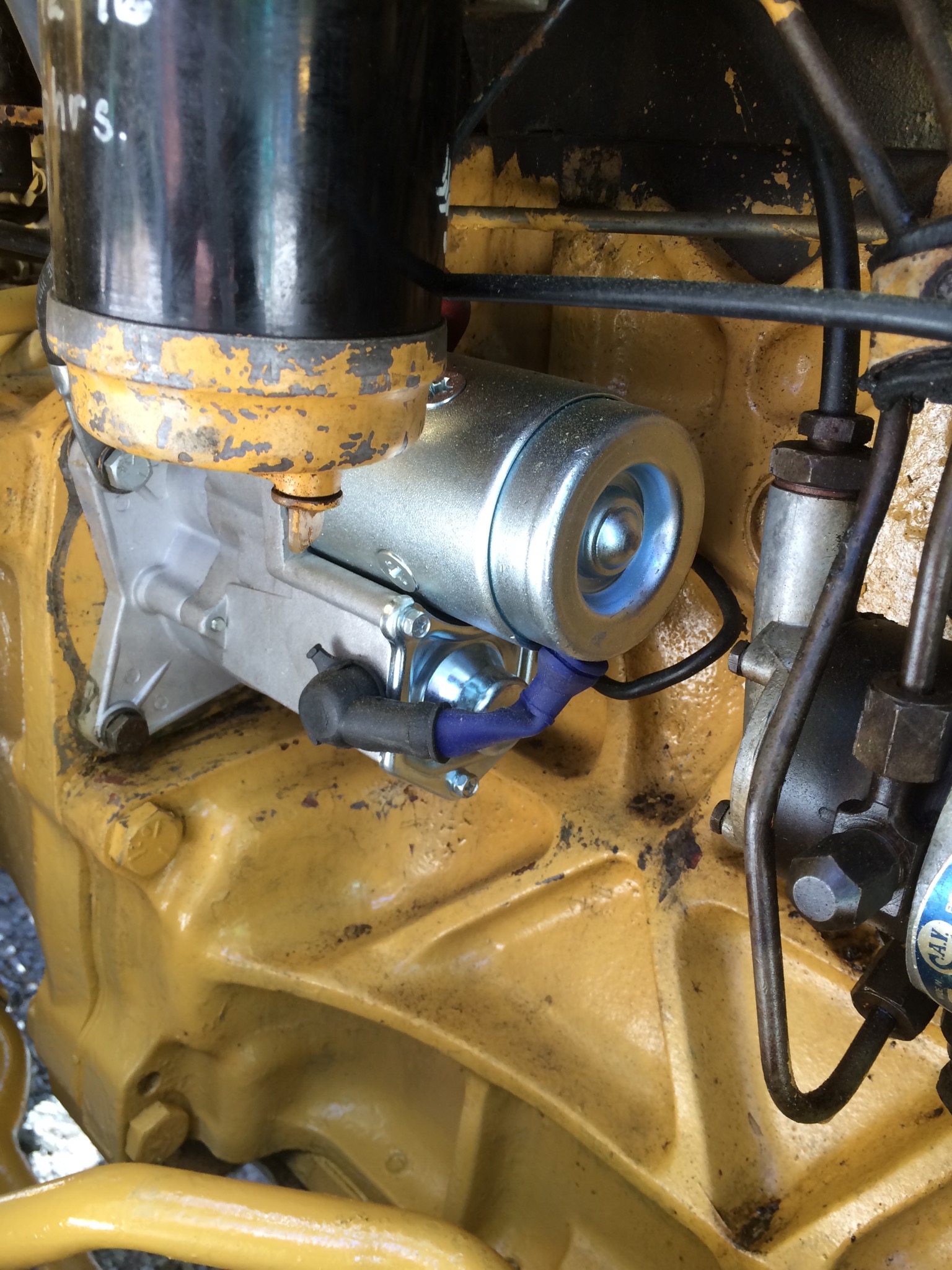

If you need fast cranking speeds in the cold season this high torque PM starter willdo it, this one is on my Ford but I think they make them for others also.

This picture did not come through on the first post.
   / A high powered starter for 3 cylinder Fords and maybe others #3
Make, model?
Made by a company called rare electrical. No numbers on it that I could find.
eBay item number 110947943173. This is the current number for the auction. It also comes up on the eBay search for Ford gear reduction starter 3 cylinder diesel.
   / A high powered starter for 3 cylinder Fords and maybe others #5
Starters are as generic and as interchangeable as socks. Just go to the Delco site and look up a MT28, MT29 or other starter with the proper mount , pinion and rotation .
Mt28 and mt29 are not PM starters, I could not find one that was for the three cyl. Ford diesel. Did you see one that was the correct? What is the number?
   / A high powered starter for 3 cylinder Fords and maybe others #10
Starter nose and solenoid are oriented wrong for the engines being discussed. Starter pictured isn't doing to mount on the Rh side of block facing forward of flywheel with the solenoid up which is how a starter mounts on a 3 cylinder Ford Basildon engine.
