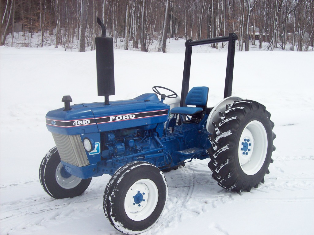

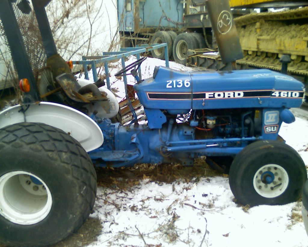

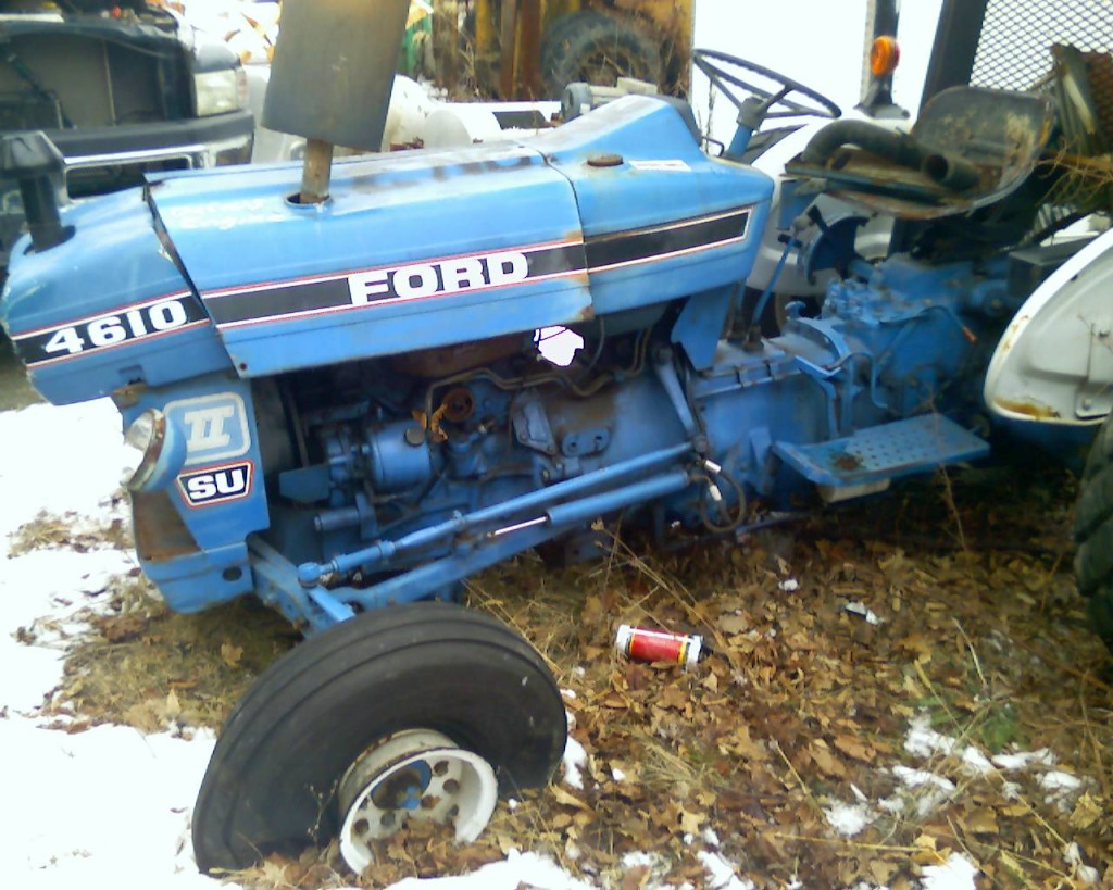

before and after.... started out as a 4610SU
I dragged this out of my buddies salvage yard in march 2010 with a cracked block. What I did: used block, bored and sleeved back to stock, complete engine kit, crank ground,head done, injection pump rebuilt, injectors rebuilt, new fiberglass nosecone, grill, headlights, seat, starter, alternator, drawbar, new rear rims, wheels, and tires, used longer front spindles, new spindle bushings,used front tires and rims, new paint and decals, made a whole new wire harness, including new battery and key switch with a battery master switch. probably some other stuff I cant remember.
