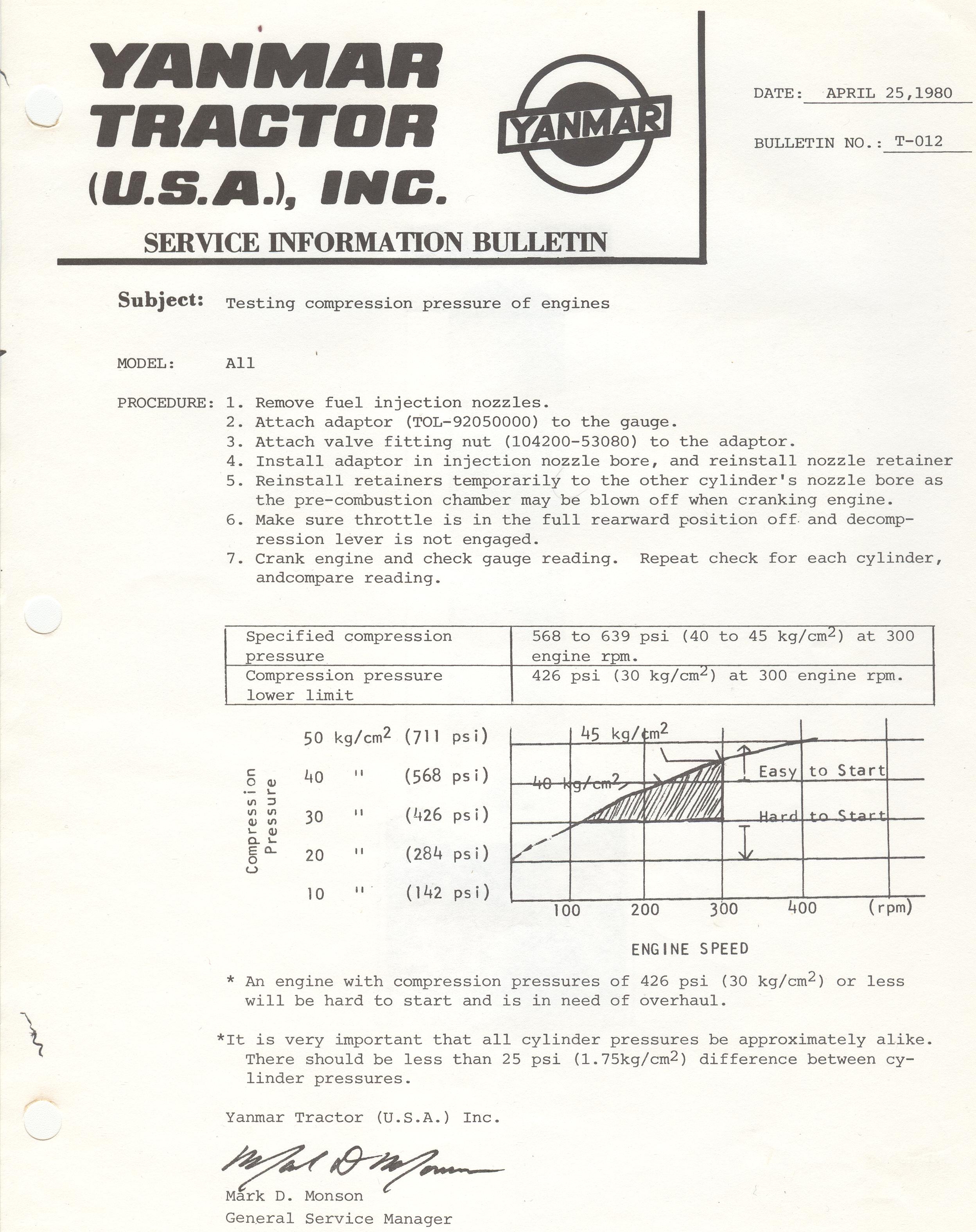

If you do try a compression test, be sure to use a Diesel Compression Gauge. It goes to 1000 psi - much more than you can hold by hand. A gauge for a gas engine will not go high enough. In any compression test, test each cylinder by cranking the engine as close as you can to the same number of times, and with the throttle shut.
The Yanmar procedure is good for all diesels, but procedure 2,4,& 5 are specific to diesels that have pre-combustion chambers for indirect injection that are held in place by the injector body. Not all diesels have indirect injection, but a lot of late model medium and small modern diesels do use indirect injection. In these there is a possibility that the pre-combustion chamber can come loose during a compression test if the right adapter isn't used.
Note that the graph shows the different pressure that can be expected with differing cranking rpm.
