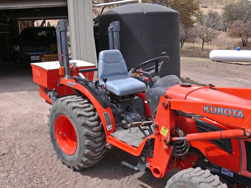

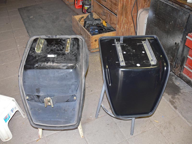

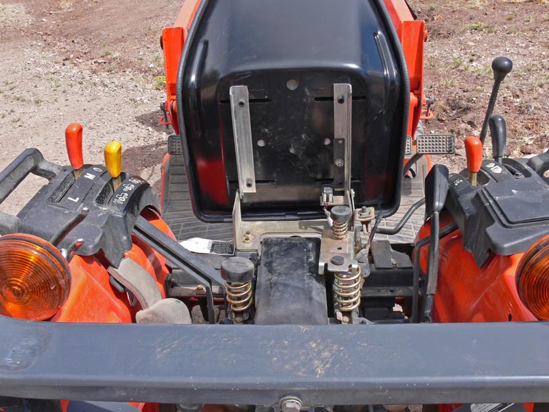

One of the things about my Kubota that doesn't sit well with me :silly: is the seat. Black. Hot West Texas sun + black is not a good combination. I tried a seat cover & while better, I have to get off & on the tractor frequently when doing landscaping projects. The seat cover wanted to come off & it didn't let me slide across the seat very well. After a lot of searching I found a seat that would fit my B2620 without a lot of work. A couple of short pieces of angle iron was all I needed. I had to do a minor adjustment to the seat switch (bent the bracket up a bit.
Here is a link to the seat
https://www.allpartsstore.com/ItemD...&SearchItem=1&TextSearch=&ItemNumber=TMS111GR

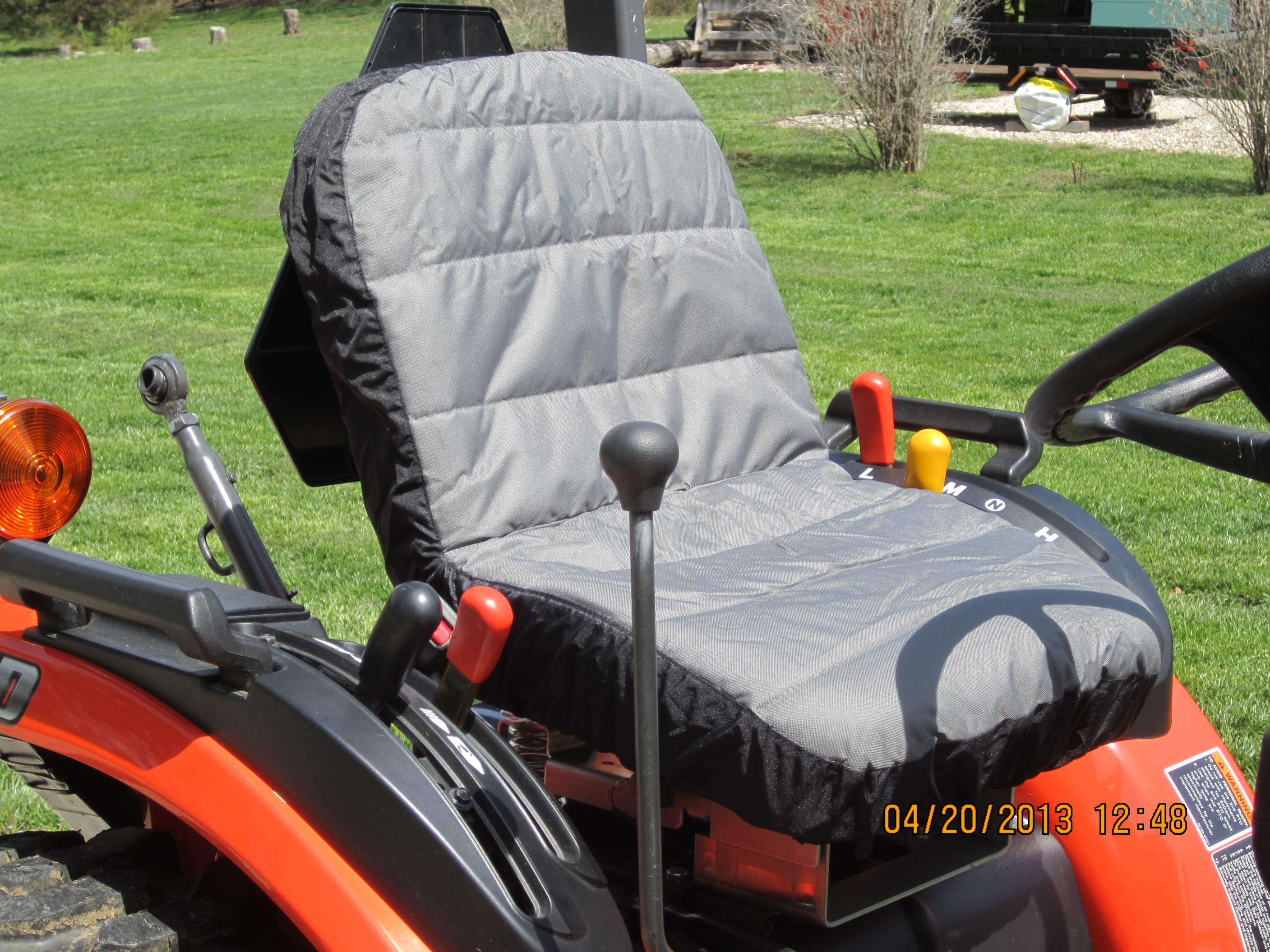

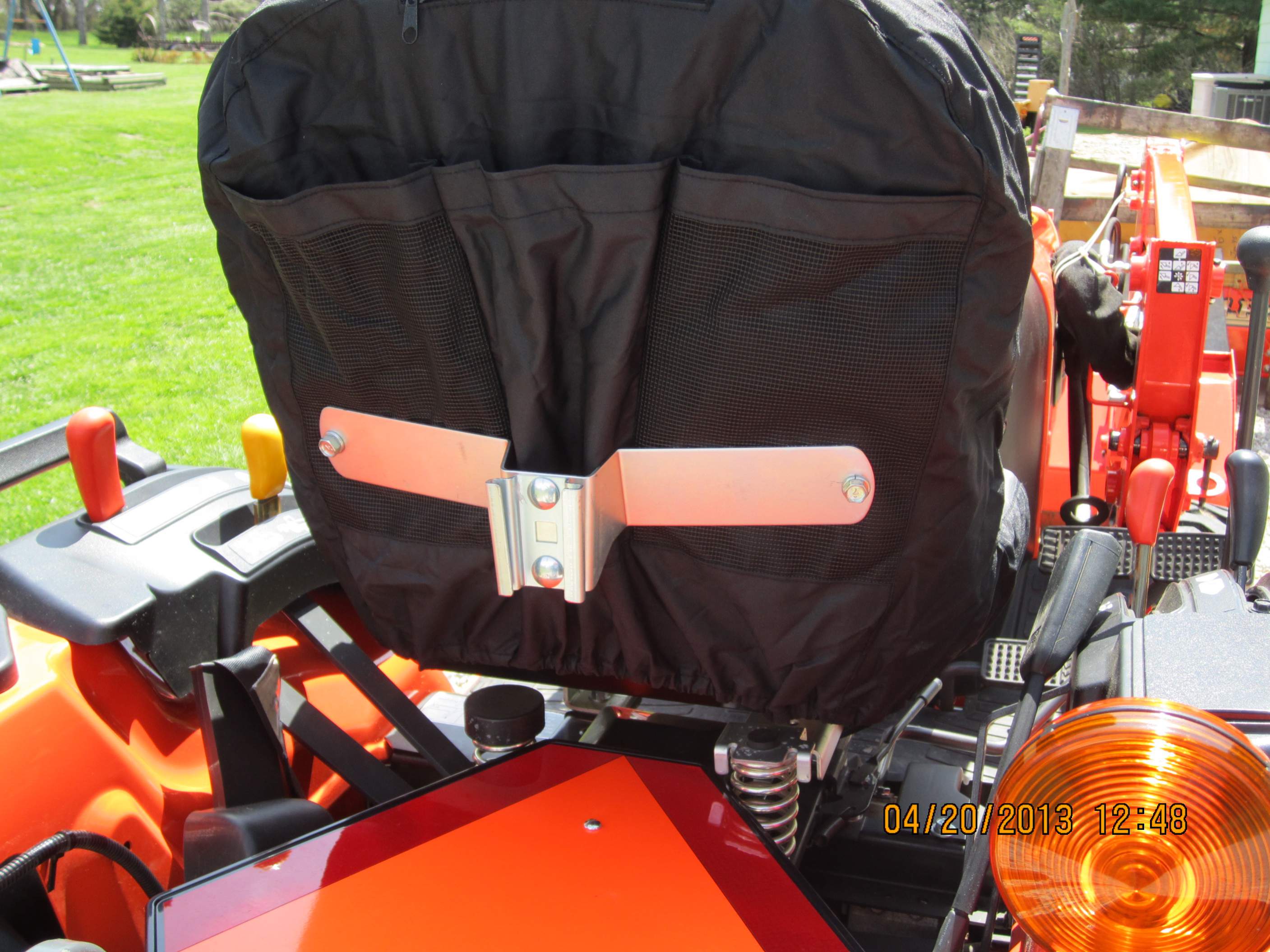

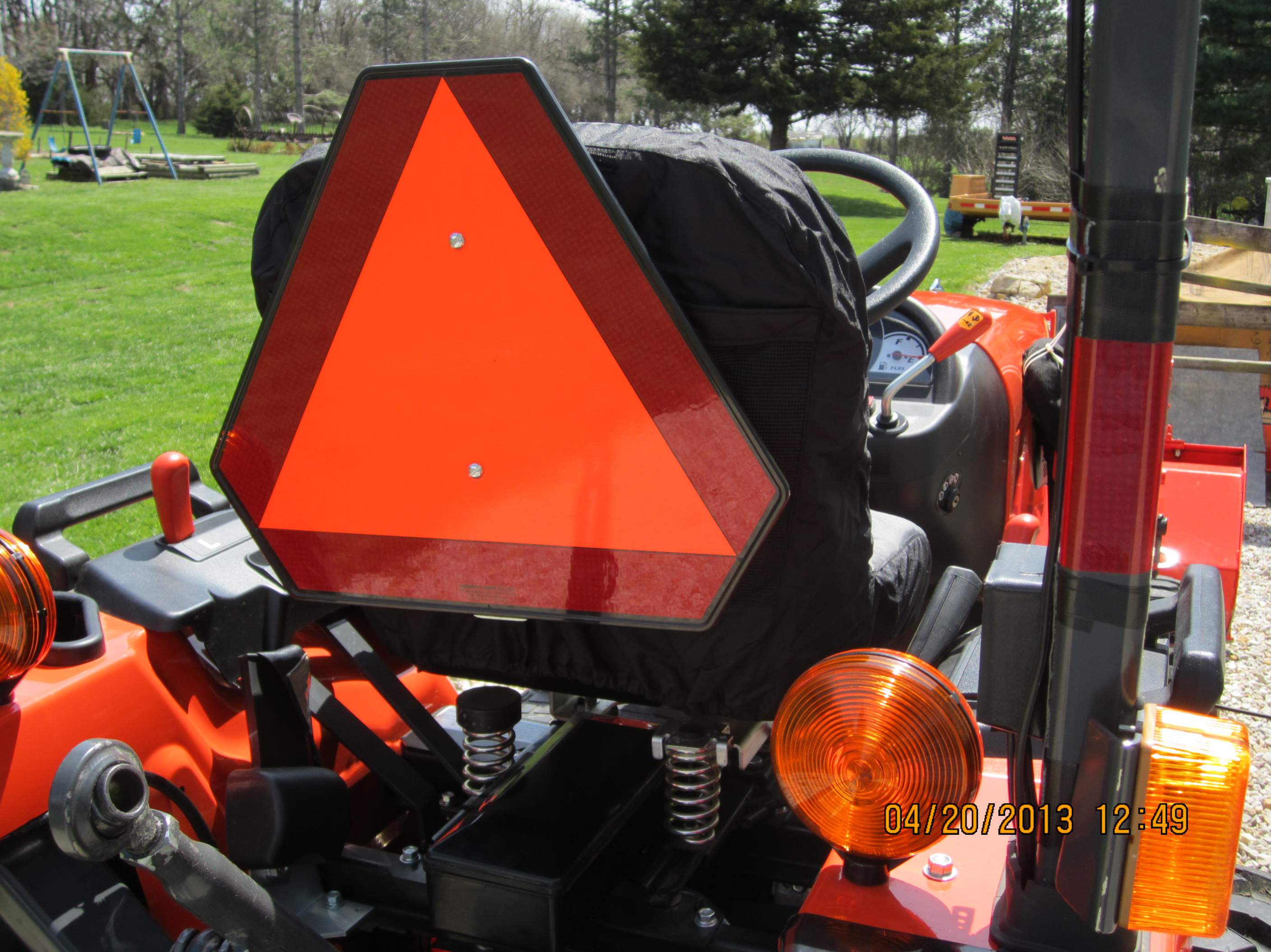

I came across this seat cover in another thread on TBN. Note that the SMV bracket holds the cover in place. My issue wasn't heat so much as ripping the Kubota cover with a tool in my back pocket. But Locoweed's new seat looks nicer. But this cover only cost about $25 with S/H.
