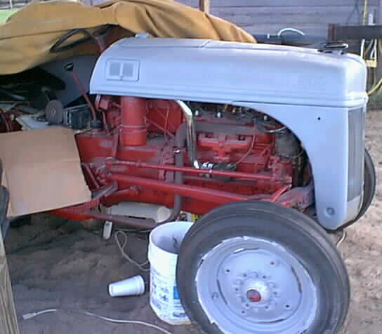

I've been sanding and sanding.. and sanding some more.
Shot some primer on it to protect what I've already done, and as time permits, I'll sand some more.
Pleased to say there is very little bondo on the sheet metal.. many of the dents popped out, or were beat out.

<font color=black>Thanks. It has been a tough time on this tractor. The few parts it was missing were easy to find. I did learn how to use a few more tools that I previously didn't know existed.
The previous owner painted the tractor with a brush... badly.
After taking that down.. I found that someone else had painted it ford blue at one time... looks like they dipped it.. even the chassie had blue under it.
I've wirebrushed/wheeled the chassie to remove the flakes. Luckilly no rust or leaks on the frame.
I figue by christmas I'll have it ready to paint and put the lights back on, etc.... If my wife doesn't go crazy first...

I need to re-paint my Ferguson TO-20, but I use it almost everyday, so I can't afford to take it out of commission. I was thinking of handpainting it with a fine brush, and rubbing each coat down with #0000 steel wool. That way I can do it quicker, without having to take anything apart.
Do you think that might work? I'm not a perfectionist, I just don't want it to rust!

Oh come on Rich, go all the way! Bead blast it down and give it a good spray job./w3tcompact/icons/smile.gif/w3tcompact/icons/grin.gif Na, just kidding. The problem with sanding is that most of the harder paints, you will just sand the gloss off. The paints thst sand well, just are not that strong. Best bet? Spray bomb. Scuff up the rusty stuff, and hit it with a can of spray paint. Works well for what you want. And it will give a nice smooth finnish. Oh if I ever get my shop built, I will be putting in a paint room, but we will all be dead and gone by then/w3tcompact/icons/smile.gif

To be honest, for a 'working tractor finish', you could probably leave the sheet metal on it, and start sanding / buffing the heck out of it whenever you get free time. If you expose some metal, it may get some powder rust on it from day to day.. but a scotchbright buff pad on a drill or buffer removes it quickly.. and leaves a nice finish.
Sand it down, wipe it with a tack cloth, mask it with newspaper and tape, and prime it with the metal still on the tractor... rattle can primer will be fine.. just remember, side to side spray motions, and release the valver between each spray motion... takes a bit longer.. but you can make a nice finish with a rattle can if you have a steady hand, and good environmental conditions.
Sand the primer down with 600 or 800 after it dries ( rattle can paint dries fast!.. but don't paint when it is hot... solvent will boil and leave bubbles.
After that final buff, tack cloth it again, and rattle can paint it with appropriate paint.... ford and tsc both carry equivalent tractor paint colors in both rattle can and bulk cans.
If you get the sanding done on say a saturday, if you get up sunday, and the weather is good, you can probably prime and paint it in one day. Won't be a showroom finish, but it will protect the metal , and look halfway decent.
Rattle can finish may look better than brush.. just depends on your hand and eye.... rattlecan may dry a bit faster too.
The frame will be easier.. just wire brush it to get loose paint off, then hit it with a couple good coats.... the undercarriage takes a lot of abuse, and isn't under the same scrutiny as the sheetmetal.
Heck.. after it cures good.. hit it with some cheap buff on style car wax.... it will look cherry the first time it rains!
