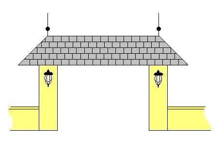

BTW, this is the original concept drawing I had in mind for the canopy. It will eventually look like this.
