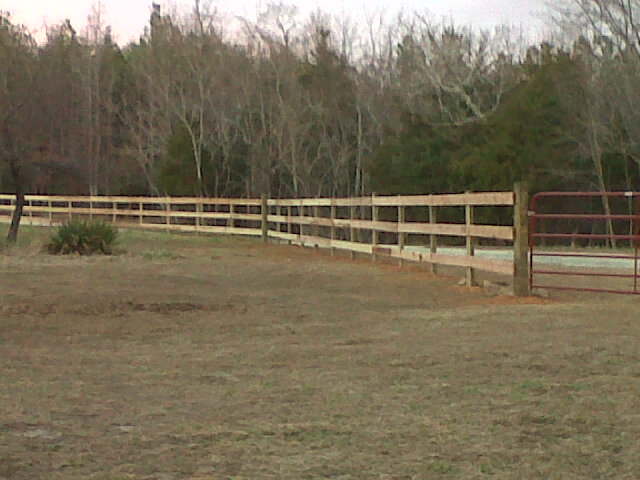

I have encountered an issue on my Horse Pasture fencing project... (pics are old pics of the first section of finished fence, about 380' or more).
I went to my local hardware/feed guy who has been my supplier for all of the fence I've built already, and he cannot get the poplar 5/4" x 6" x 16' boards I've been using.
They have some kind of pressure treatment he says, and they've been shipping them all to China and it will be weeks to months before he can get ANY.
They have held up well so far and given I will end up with well over 1000' of fence I was NOT planning to paint it. I need to build a 40' x 40' enlosure with runin shed/tack room, and the next 250' of fence.
He has Pine and Oak, but they are both more costly, AND they do not look the same (which will make SWMBO demand I paint them).
What to do?
I'm thinking of only doing the 40' x 40' and waiting till he can get boards.
Thoughts?

Just out of curiosity, why do you use the treated poplar instead of decking boards? I didn't know treated poplar existed until a month ago. Forgive me for being ignorant. :eek:
   / A Question on my Horse fence project
DT86,
#1 I did not know they were treated until just last month when I went looking for more. They ARE weathering VERY WELL...
I bought these last Nov when I started my "Temporary Pasture" project http://www.tractorbynet.com/forums/...horse-pasture-fencing-advice.html#post2542957
I had just been looking for inexpensive fencing boards. I had found 1" x 6" x 16' Pine and Oak at TSC, Lowes, Home Depot, and my local guy (Homestead Hardware) and his prices for post, gates AND fence boards was better than anyone. I think most all of them were 5/4" or minimum 1" thick, and while rough cut, they were MUCH stronger looking than the "decking" boards some people use which are only 3/4" I think.
My routine is to climb the fence to get in/out of the pasture, and with 8' spans I like a sturdy board, plus it was VERY reasonably priced.
The pine were twisty, the oak were greenish (now I know they were treated, DOH!) and knotty. the poplar were smooth, straight, and clear.
They are REALLY Nice to work with I feel.
Be well,
David
