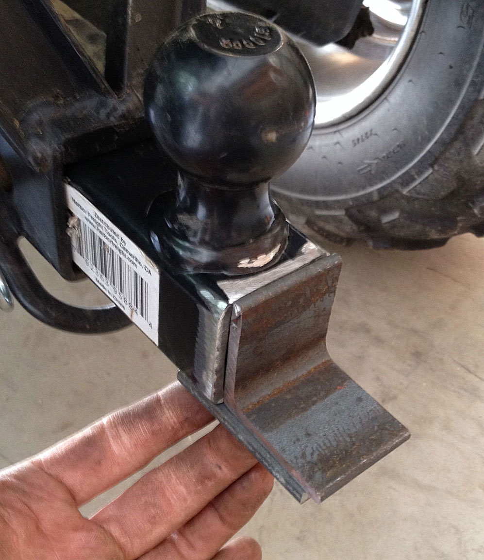

Re-post because original thread went crazy off-topic (sorry).
This is a simple example of a project that shows welding that's well-within the capabilities of a 120 wire feed welder. The hitch would be used to tow a small trailer, or any item that uses the simple clevis-type hitch.
Here's an example of welding a trailer hitch for an ATV. Miller Multimatic 200 running on 120v from a pair of Honda EU2000i generators. Welder was 'preset' for 3/16" thickness. The angle iron is 3/16", the hitch sq. tube is 3/16", and the doubler below is 1/4" thick.

You still need to be concerned if you're getting enough penetration. That's why it's good to do some practice welds and test them.
   / A simple project with 120v MIG wire feed (ATV trailer clevis tongue) #8
Testing... if you can is always a good idea, whatever you are building that is structural. And I am not just talking about welding!
