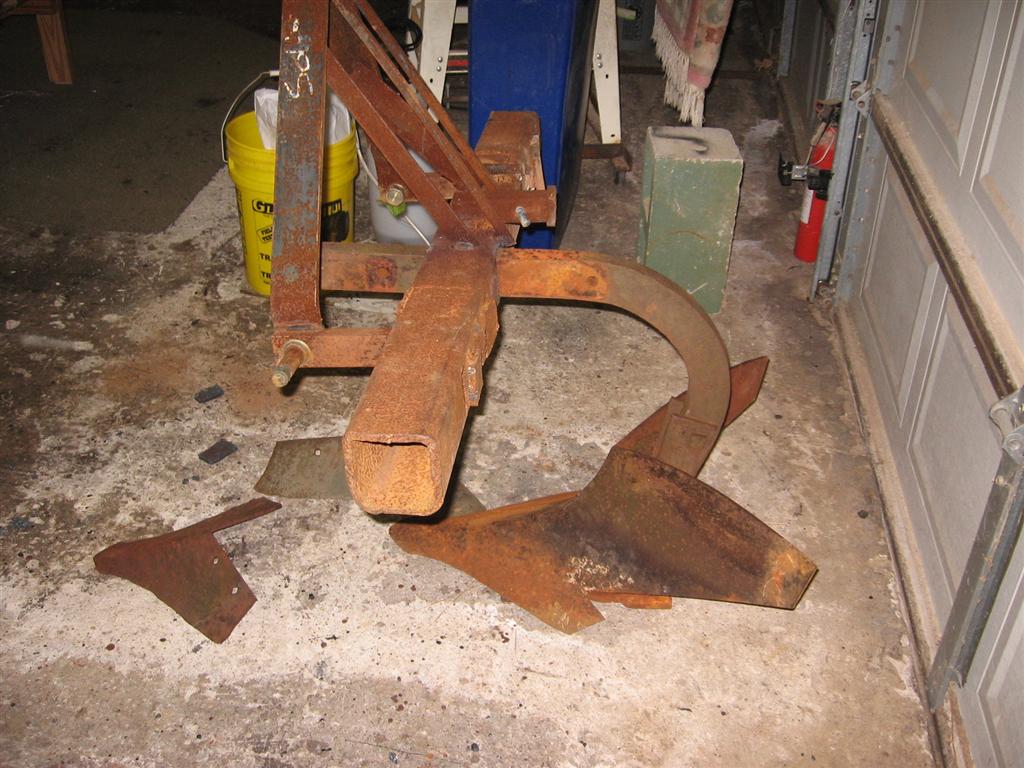

Next new attachment for the homemade toolbar. I found this around a pile an old Farmall Super M. There were 2. Just an early turning plow for this tractor? It may not look that big and heavy, but just what you see must weigh2 over 125 pounds. I can barely lift it. the horizonal bar is solid 1.25"x2.5".
Anyone know anything about the different nose pieces? Looks like they all fit the tool but are slightly different.
Rob

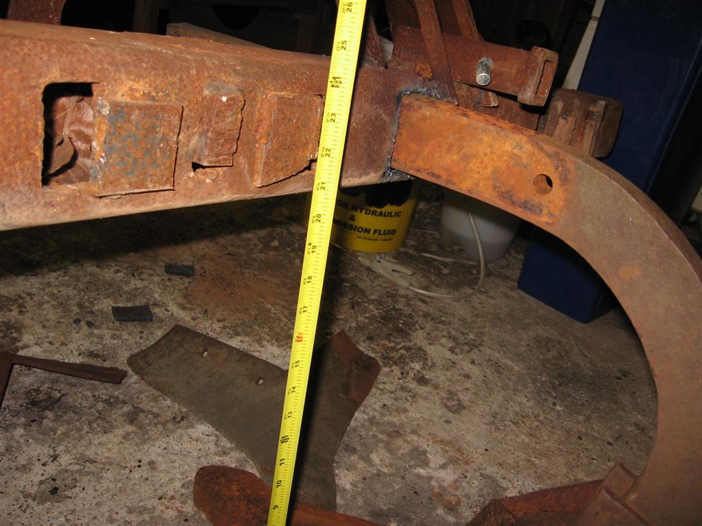

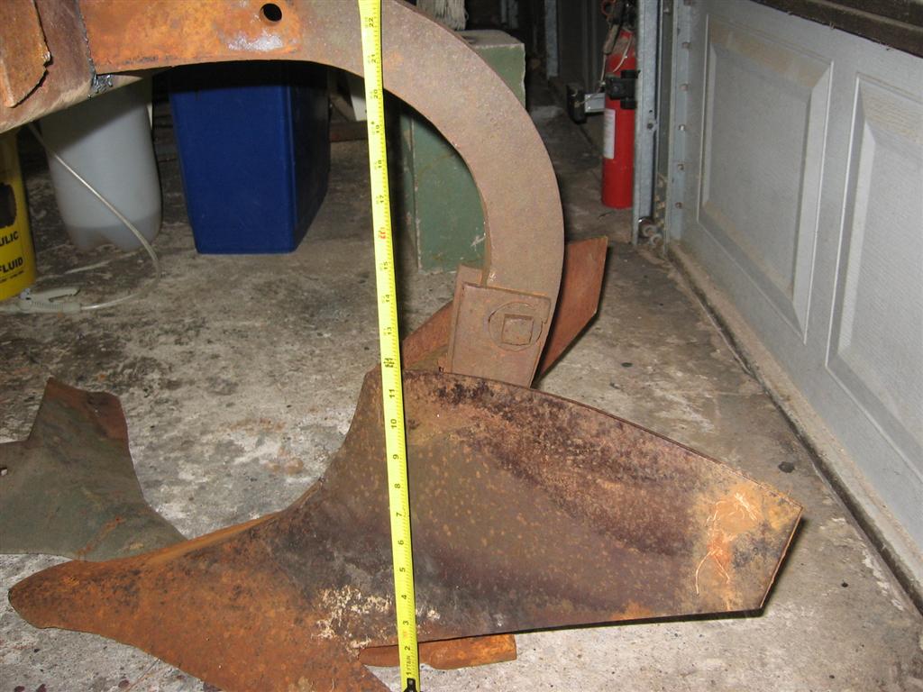

I'm curious how wide the wings on the plow are and how wide a furrow it would make?
   / A super middlebuster?

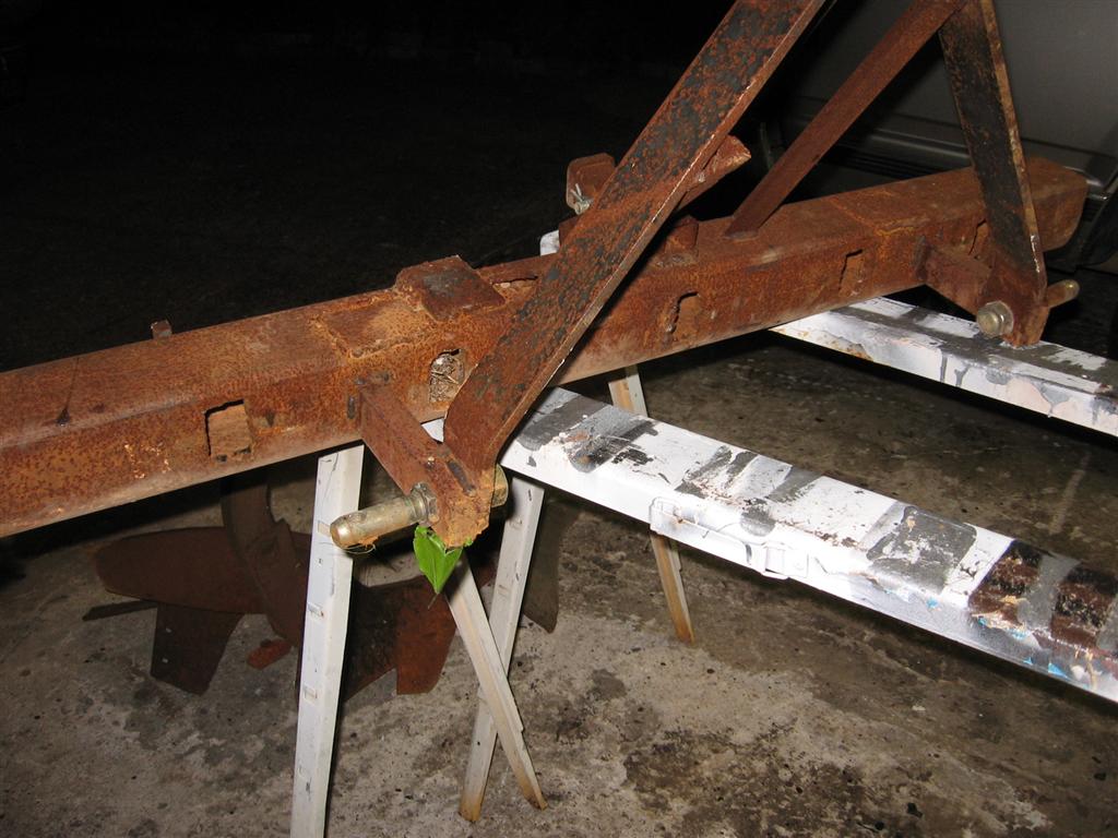

I cut the holes in the bar last night and stuck it in. The top of the plow is 12". To the bar it's 21". Total width has to be 17-20". I didn't measure that this morning.
We'll know how wide and how deep in a couple week!! :D

Rob, I have a middle buster for my row cultivator. It was once a horse-drawn implement I believe...maybe not. Anyway, there are two angles welded to it's sides and drilled so it mounts on the cultivator. I think your mounting will be fine except you will need to support the part that extends out front. If you hit a rock while that middle-buster is buried, it will twist and deform that beam like it is taffy. That plow will have much more resistance than scarifiers on a boxblade. Nice job so far.:)
#12
Rob
I was close, the total width is 21". So by default this thing should trench a minimum of 12" deep and 21" wide. Cool.
