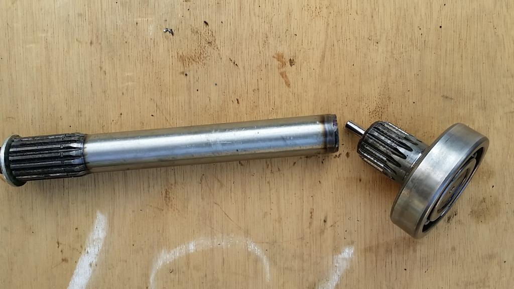

Last fall I ran over a stump and broke the 4wd selector housing. No problem. Less than $60 later for a shaft, housing, spring, seal and detent ball....good to go... However - I did have a major front drive train component break. The vertical countershaft on the right front is toast I believe. Started pulling it apart today, will finish the bench work tomorrow. The cost of the parts isn't so bad, but I hope this doesnt become an epidemic - as far as breaking drivetrain components.

Well I tore into the front drivetrain. Found a broken vertical countershaft. However - it had been repaired. Someone doweled it and TIG welded it together...lol...that didn't work out. I don't feel so bad for breaking it now. Price for a new one and shims is less than $50. I bought two....hopefully will have my 4wd system back soon!
