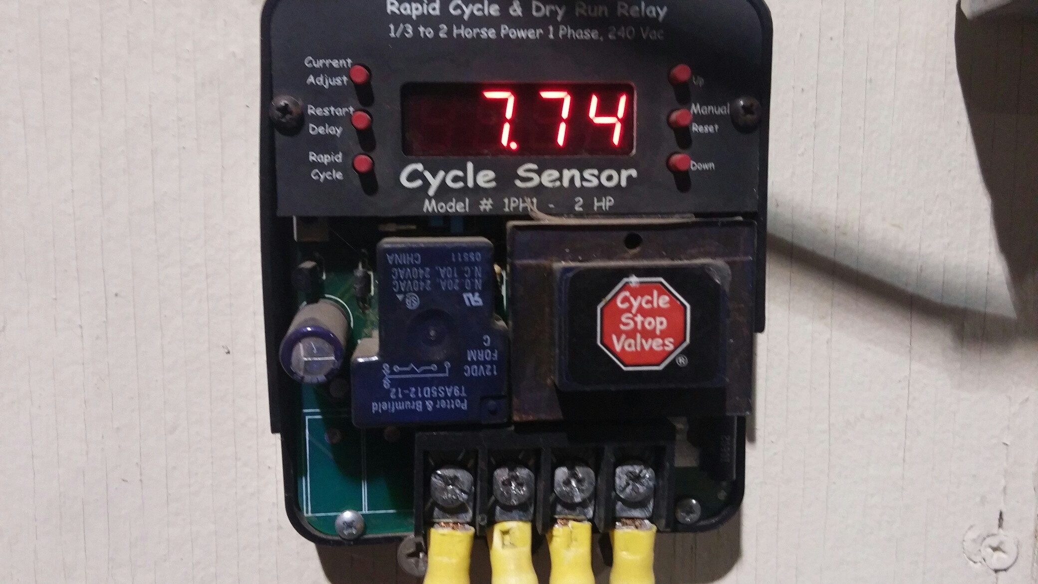

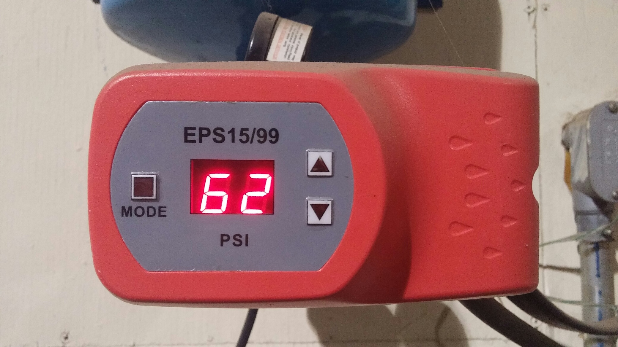

I want to add a extra digital output display, maybe a 2" numbers that will display the pressure and or the amp draw. Can a auxillary display be wire to one of them little terminal screws for the pressure so's I can see it? I've read the users guide till I gave myself a headache, A **** of a lot of Groups and Sub group codes with Parameters and Process variables. All I need to do is have some kind of brite Back lite display that I can see when I walk into the pump house. The controller drive is mounted for a seven foot tall basket ball player to read even if I could get close to the thing for all plumbing pipes in the way. I'm the only one in the neighborhood willin' to risk life and limb to go into the pump house to keep the irrigation on. Surely, in this digitally enhanced world this is possible, some how? bjr

We have been replacing VFD's with Cycle Stop Valves or CSV's since 1993. The CSV makes it really reliable. Most people with a CSV never think about their water system again. They just open a faucet or turn on sprinklers, and the water comes out reliably.
And if you want some digital readouts on pressure and amps, we have a Cycle Sensor to protect the pump and read the amps, and a digital pressure switch to read the pressure. You could also use the digital pressure switch as just a readout, they are only 30 bucks.
