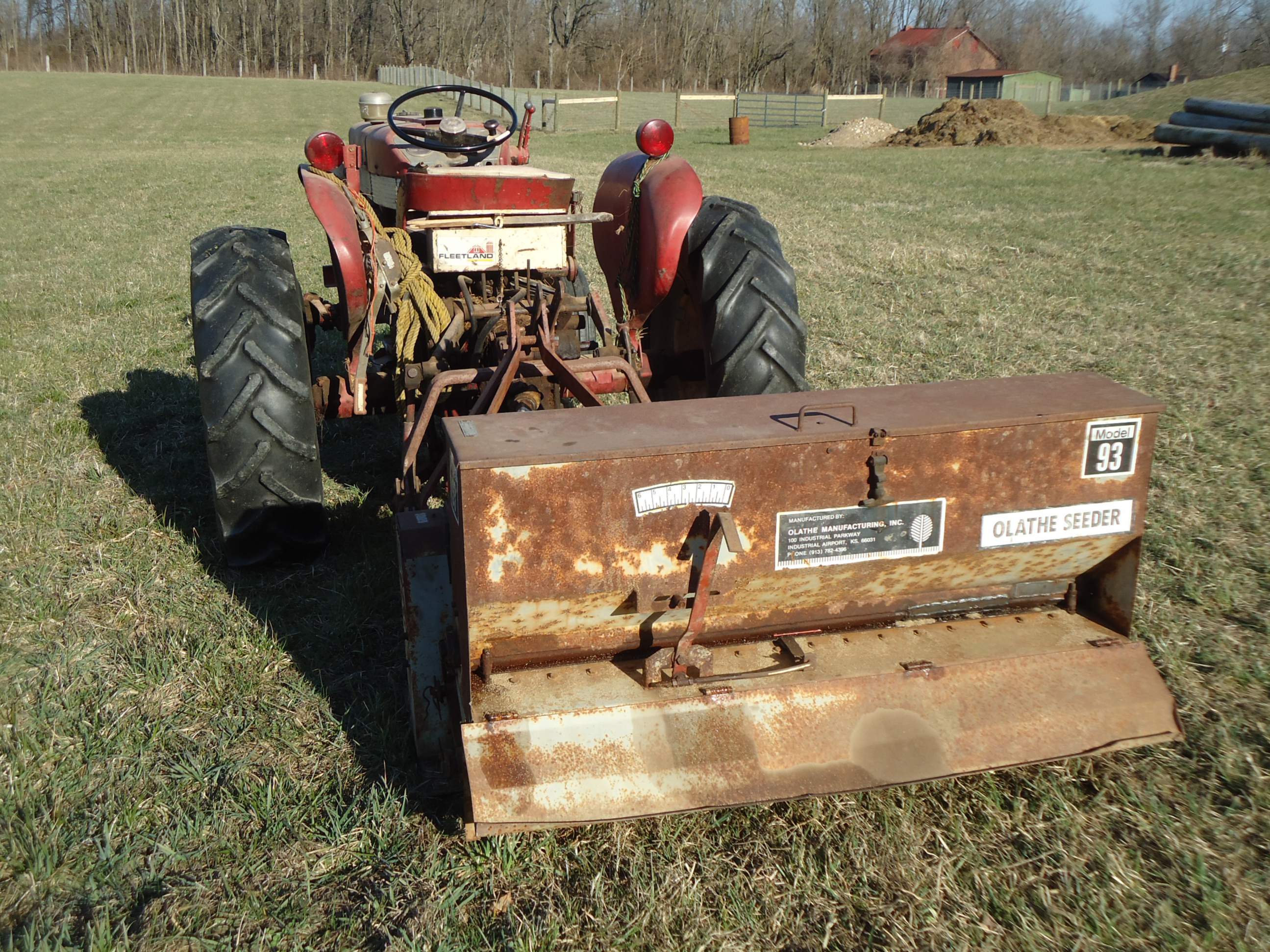

I have an older Olathe, now Toro, that was bought from a guy who bought it at a surplus school auction. It was used to re-seed a local high school foot ball field, before they went with astro turf. I downloaded the manual for it, and it said up to a max. of 6-7 mph.
I use it behind my IH 240,and pull it in 3rd gear, which at best may be 3.5 mph. Could have used the 3 cyl. Ford 2000 to gain ground speed, but use more than twice the fuel. It's not pretty, but it works great..!!
