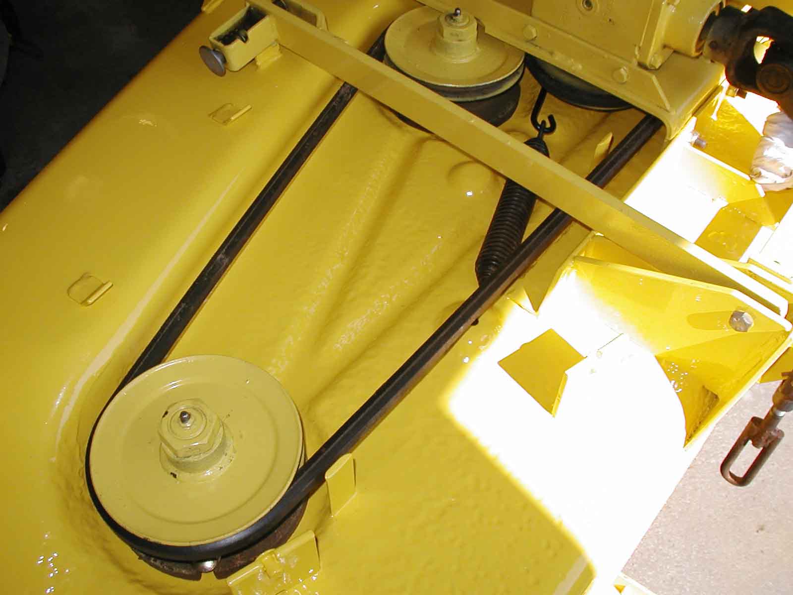

The SN label on my 1989 755 60" mid mount mower also says M02732. By the way does anyone have a manual on this MMM . When I switch in the MMM it blows a good bit of smoke before the mower get up to speed. I've pulled it off and hit all the zerks with greese and cleaned everything up. All the spindle bearings seem free. Should I swap out the dope in the gearbox, and if so with what? Thanks in advance.

"When I switch in the MMM it blows a good bit of smoke before the mower get up to speed"
The only time I've seen that was when my RFM belt slipped off the pulley. The belt was dragging and abrading between the pulley and mower deck. You might want to see if your belt is a bit slack or you've a dragging pulley.
BTW, does it smell like burning rubber?

The smoke may be a slipping belt. The initial startup places a higher load on the belt than when running. There is a tensioning spring located on the right side. In the attached photo it is just below the center spindle. The spring could be broken or missing. Also check the tensioning pulley pivot point for free movement. If this has frozen up due to lack of lubrication it may not allow proper tensioning of the belt. Finaly, check the condition of the belt to make sure it has not glazed over. You may need to replace it.

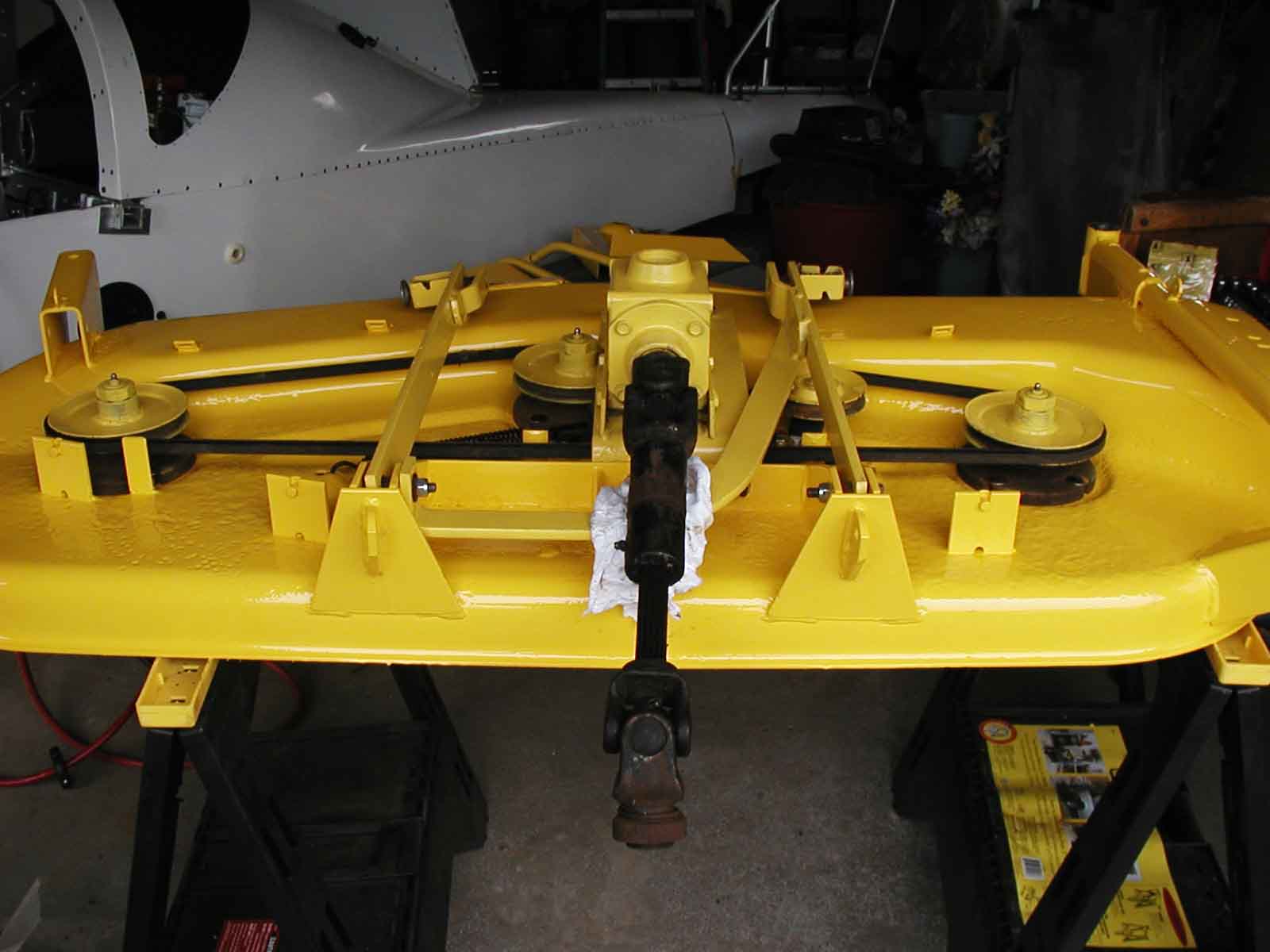

I have both the Operators Manual (publication # OM-M91324 Issue E6) and the Parts Catalog (publication PC-2114)
This past spring I tore my deck down to rebuild it. After 15 years of sitting in the weather (stored under cover in the winter), the deck was badly rusted. Spindles, gear box, lift arms, etc. were fine. I had the deck sand blasted and repainted starting with an epoxy primer. The deck was still solid despite the rust.
Let me know if I can answer any other questions on this deck.
Jeff

Here's a photo of the deck before sand blasting. I'll send another post with an after photo.
Jeff

   / ? about JD 755 mower deck #8
This is the what the deck looked like after a little cleanup.
Jeff
