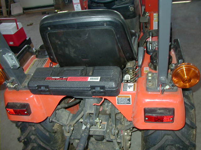

you shouldn't have a problem with an inverter plugged into a power outlet, I mounted one for my sprayer, if you look closely to the right of the tool box, it's weather proof although i don't leave it outside.
   / AC power from BX #9
you shouldn't have a problem with an inverter plugged into a power outlet, I mounted one for my sprayer, if you look closely to the right of the tool box, it's weather proof although i don't leave it outside. there is an unused wire end under the seat that is hot only when the switch is on, you can tap into that.

Milkman,
Please put a 10 to 15 amp fuse or circuit breaker between your batttery and 12v outlet if you haven't already done so. I have seen both ruined equipment and batteries from using unfused outlets when getting a short. If you are pulling more than 10 amps off a cigarette plug type adapter you really should think about moving up to a beefier direct hookup.
My .02 cents,
mark
