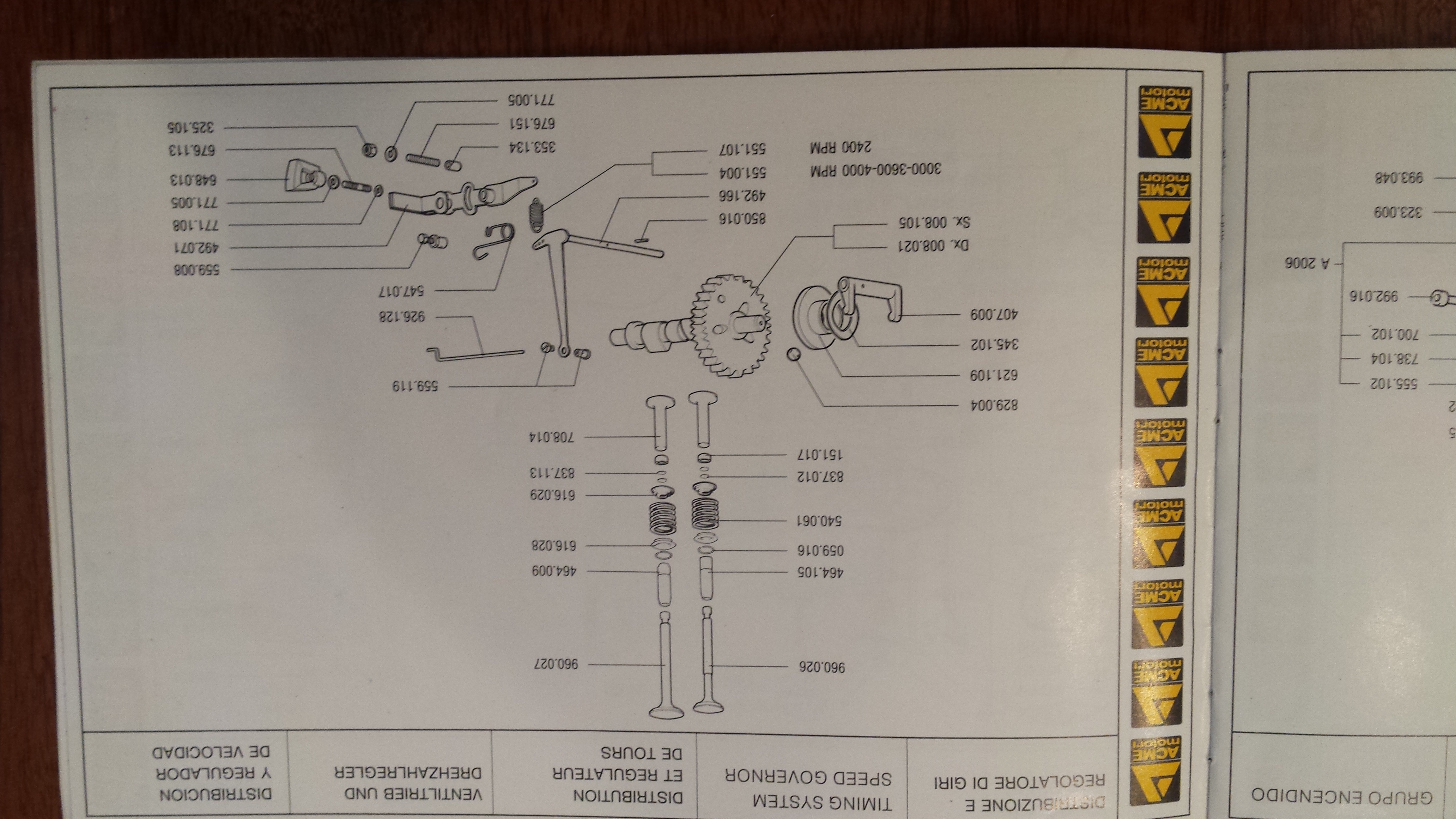

My copy of the workshop manual is a ?th generation photocopy. The pictures may or may not be clearer. I have also included a parts diagram from the operator's manual. Important text in the connection paragraph is "... without binding". Are you sure you have the correct spring? The adjustment paragraph describes adjusting the clamp on the rod. Joel at Earth Tools has been helpful keeping my old, but reliable engine running.
