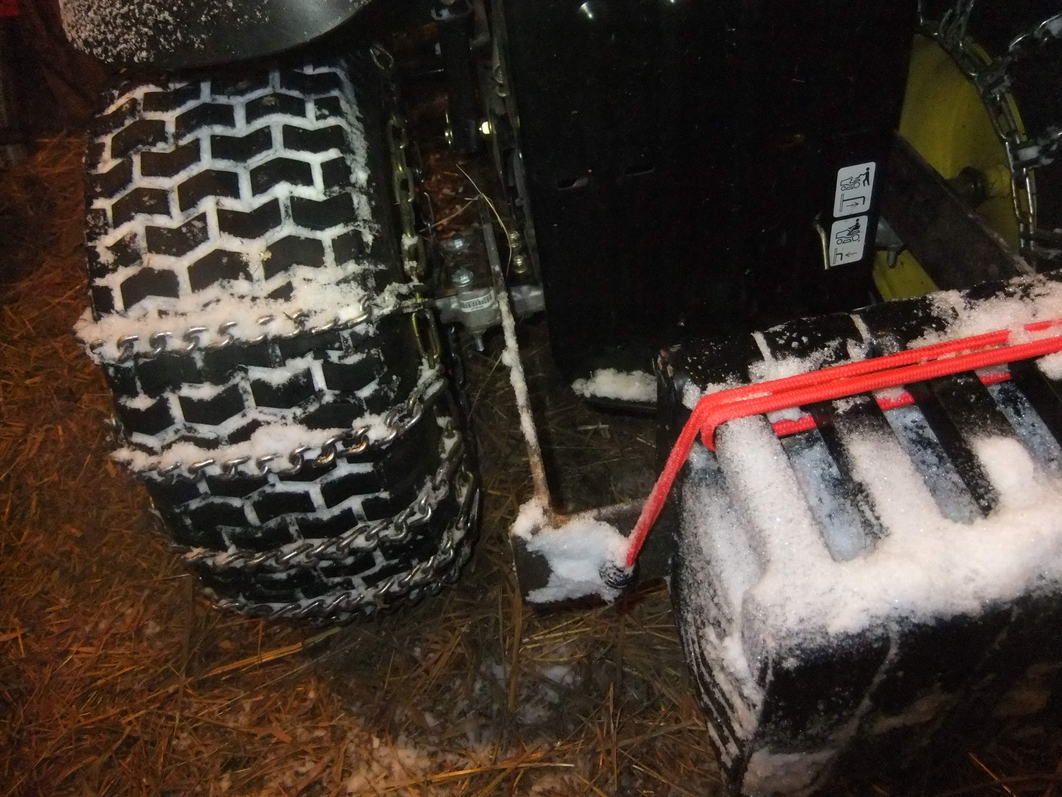

the job is already done but want to share my experience on adapting craftsman snowblower models C151611731 and C151611741 on John Deere 100 series
first : measurement and fitting
2nd : three major modification in total to be done, on the tractor, and on the sub-frame of the snowblower
3rd: adding counter weight on the back
to do this you need some pieces of flat steel 1/4''x3'' thick and 7.5' of 1' square tube 1/16 and 1/2'' x7.5'' square rod, and a dose of patience
will post pictures later

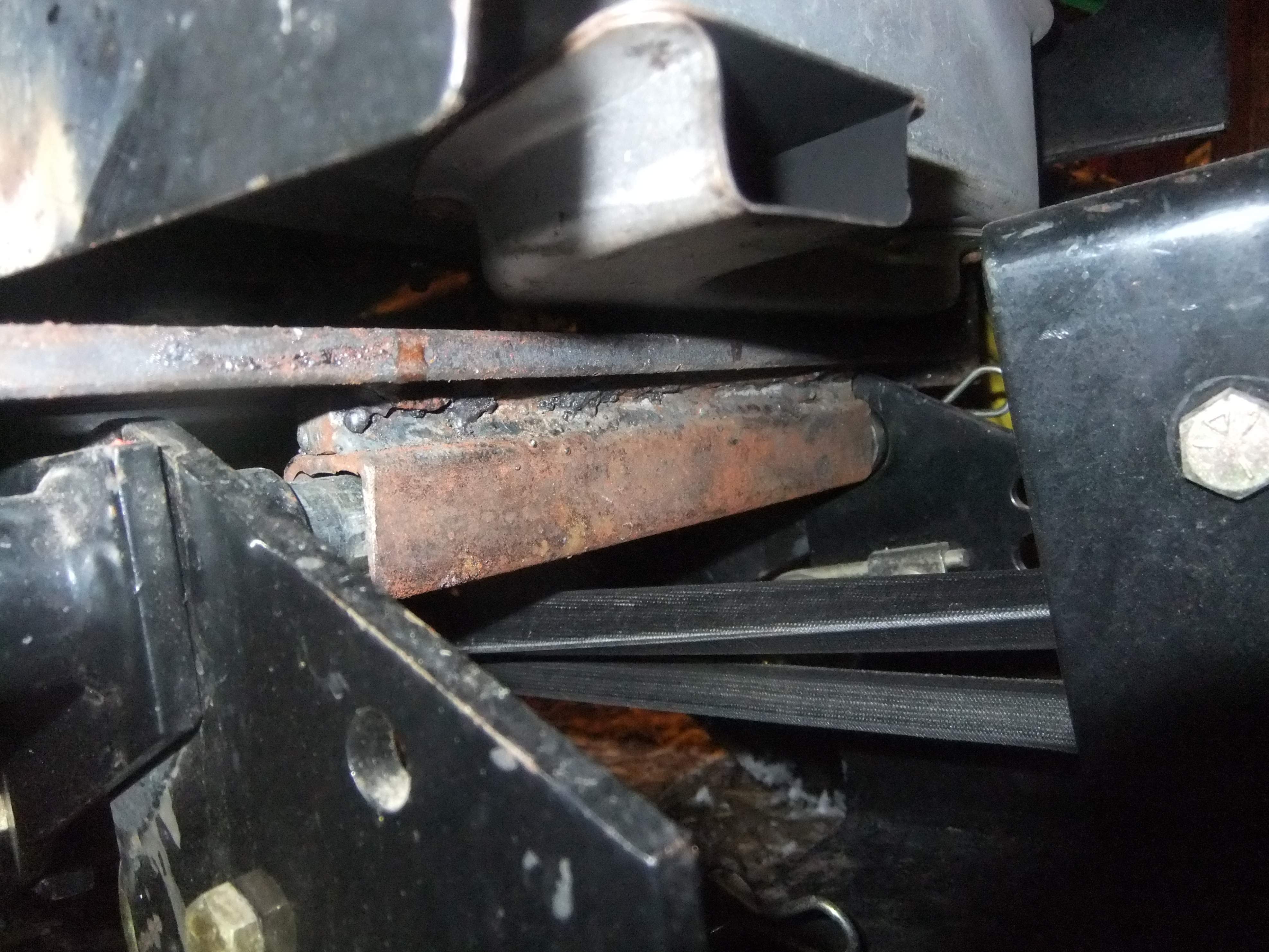

I removed the front holding mower bracket and the muffler protector.welded a holding brackets together and a square pipe to hold the front snowblower frame, the frame's rod passes through the pipe, add 1/4 '' spacer under the two idler grooved pulley, to put in line the belt between the engine pulley and the idlers one, add a belt tensioner as mentioned on the picture, adjusted the belt tension when the snowblower is down because its the position where the belt tension is at it's lower level, it' very important to have a spring in the belt tensioner, it helps to put the tension at constant level without damaging other components.

i have sprayed a vegetable oil on the chute and the impeller heavy snow doesn't sticks on
