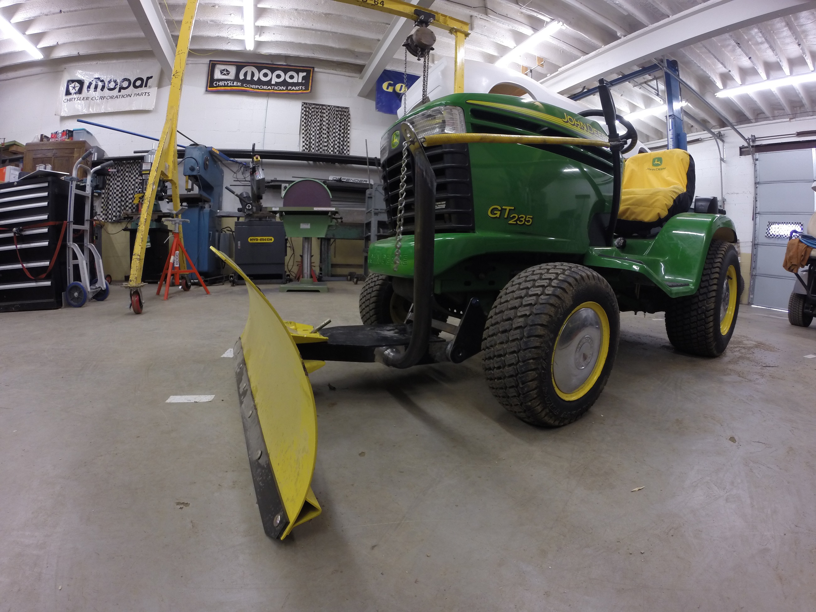

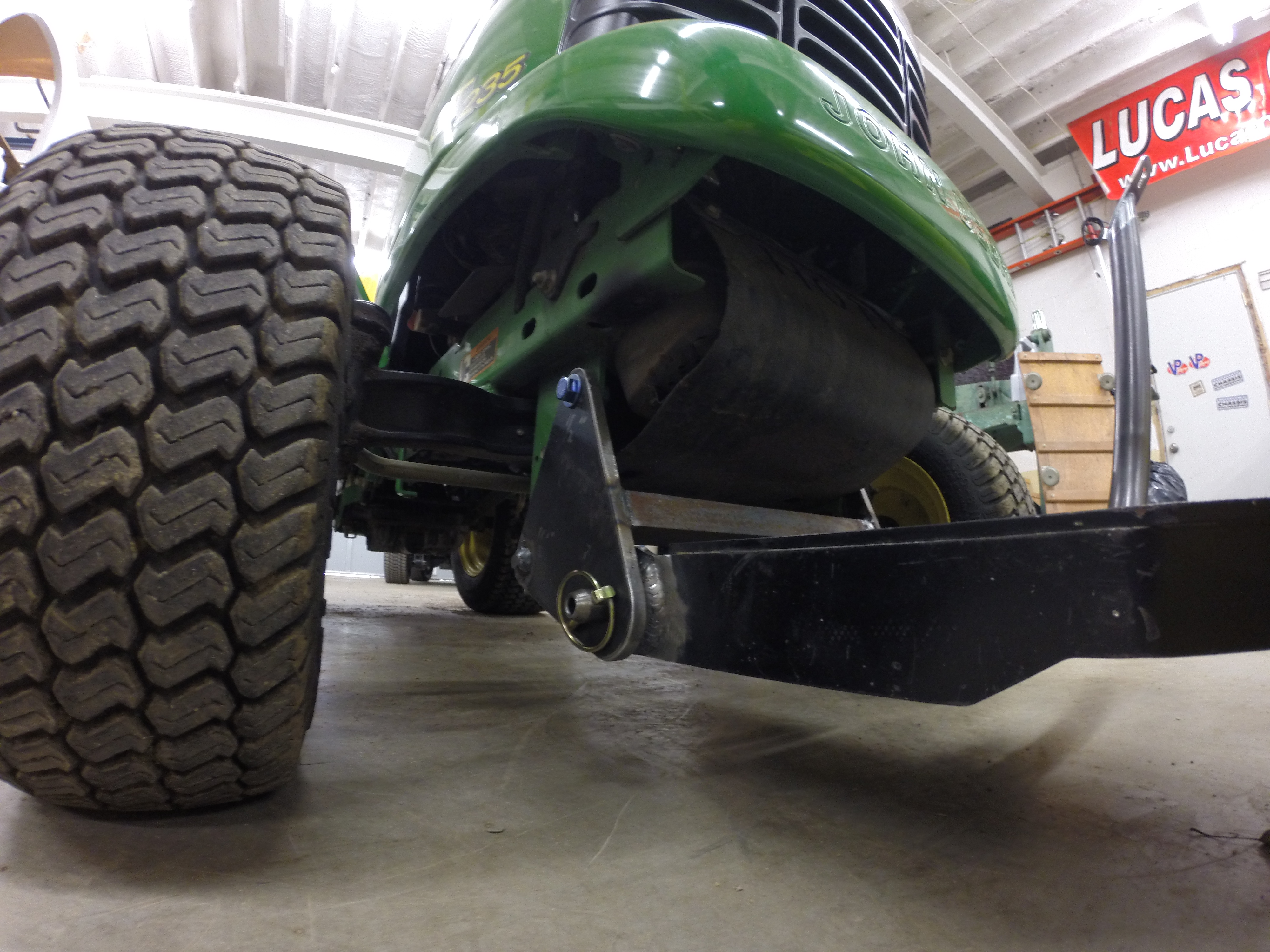

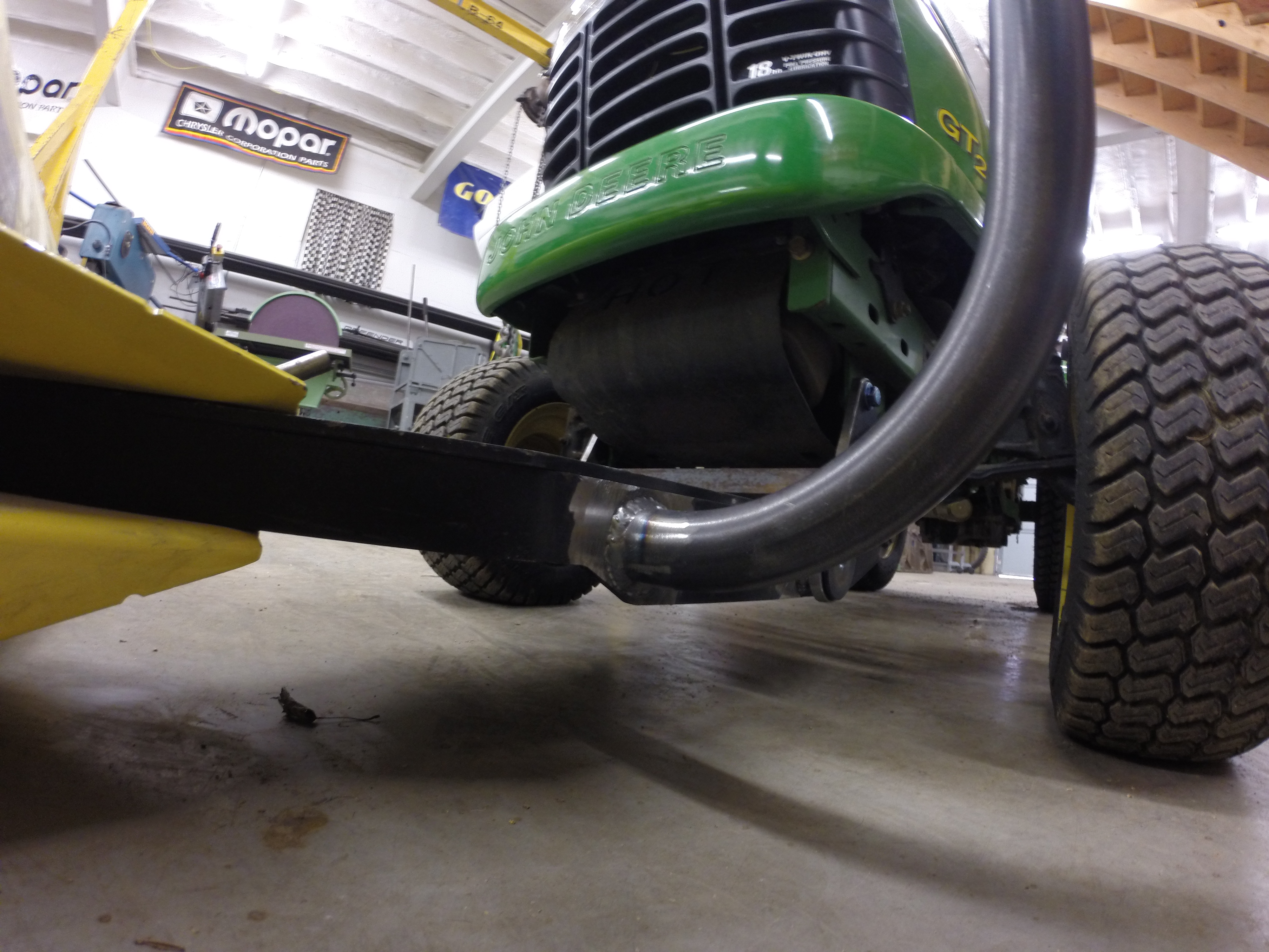

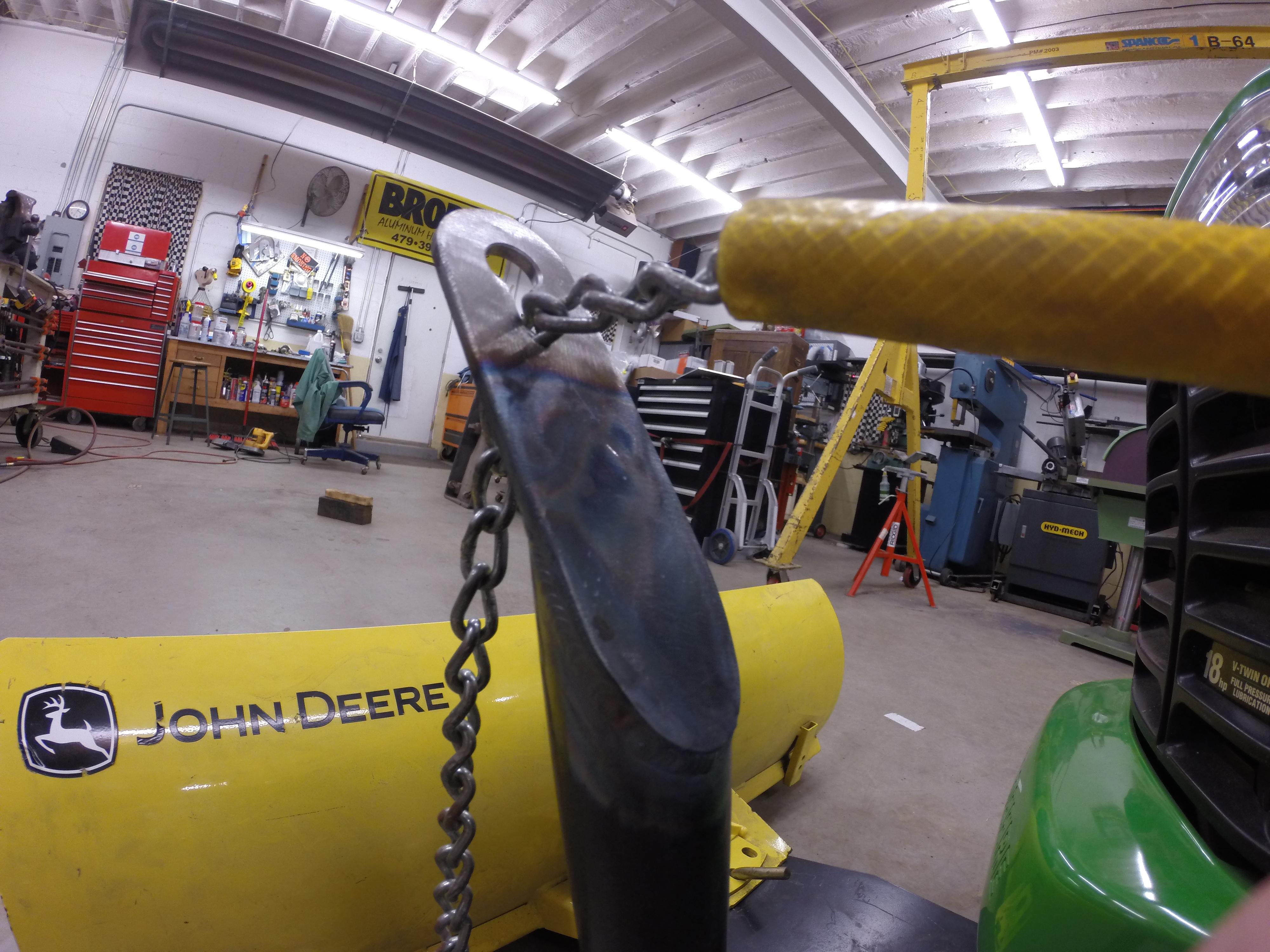

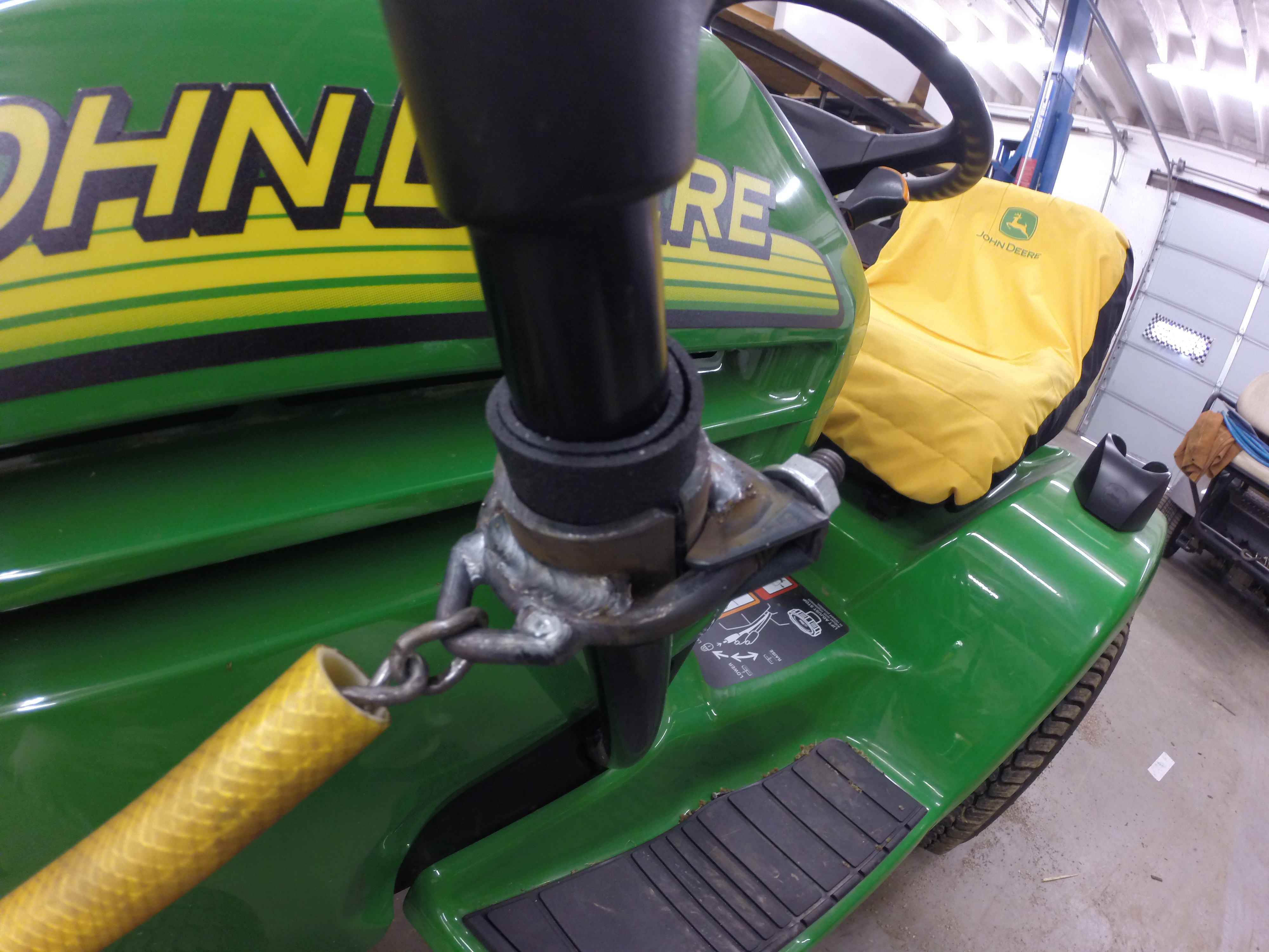

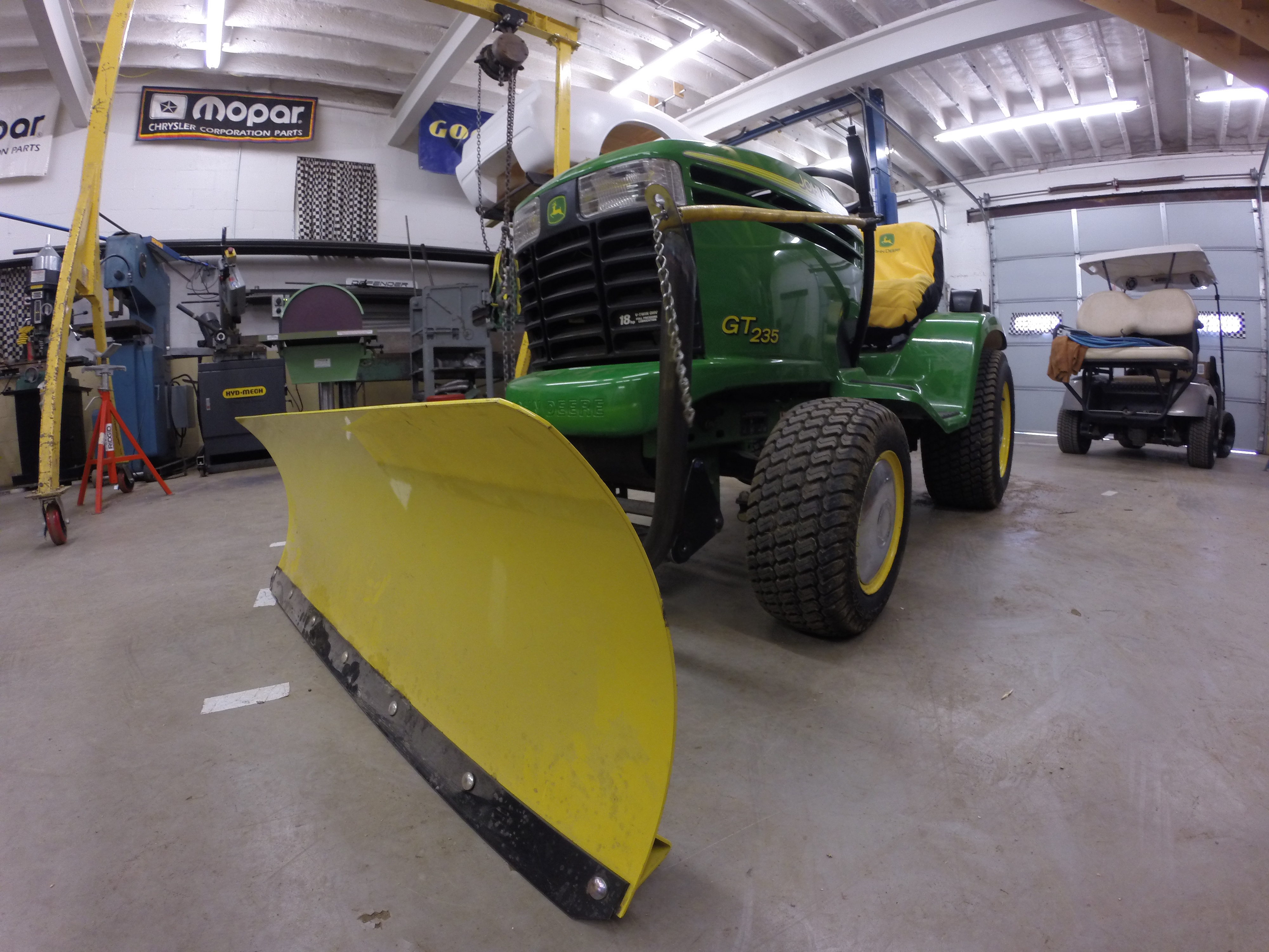

I have a fab shop where I do mostly racing related fabrication but my father wanted a blade put on his John Deere GT 235 so I got the project. The blade and yoke were original JD parts but the pieces to make it work on his tractor were not available. The video and pictures below detail the process I went through to make it all work.
