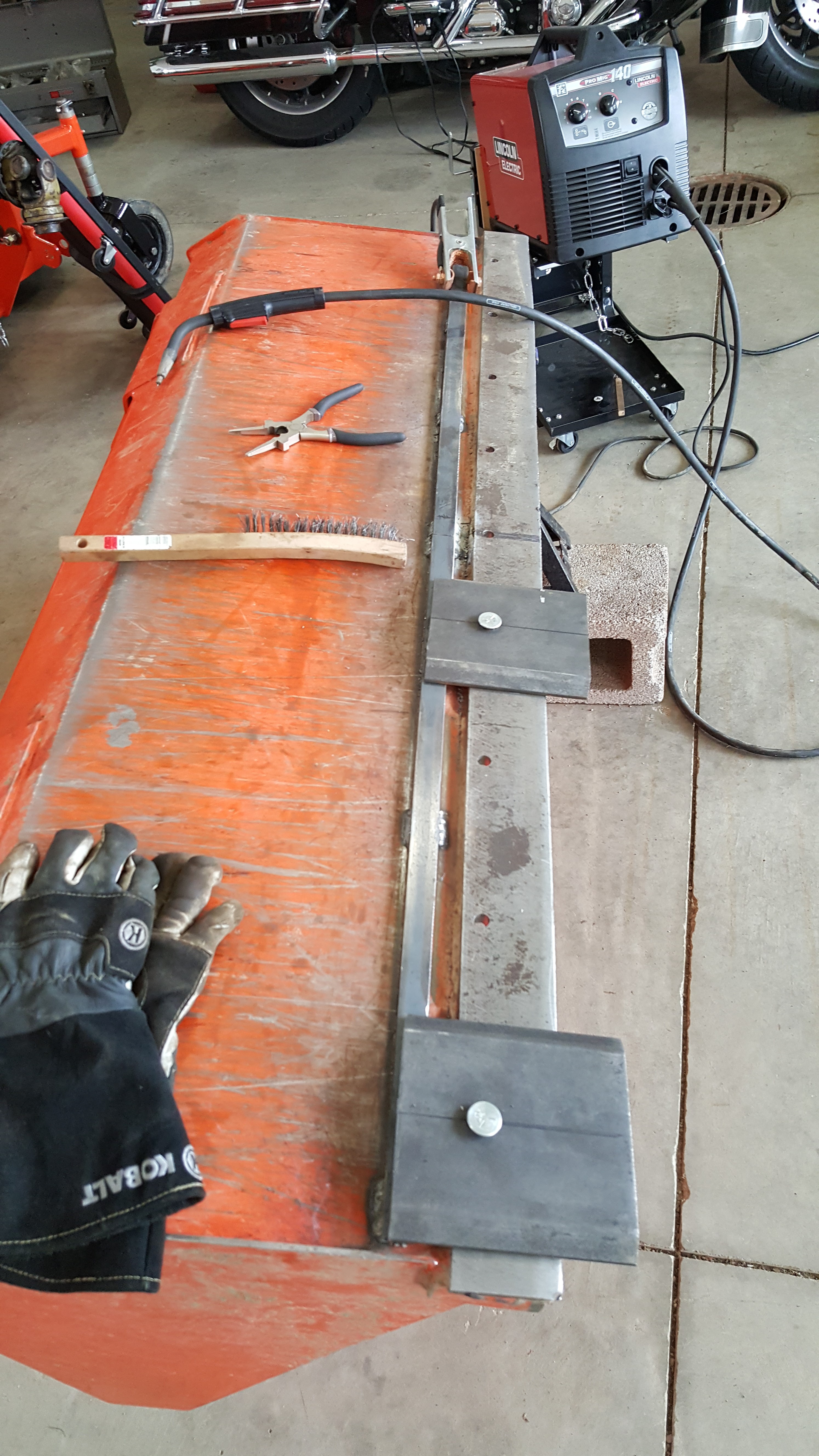

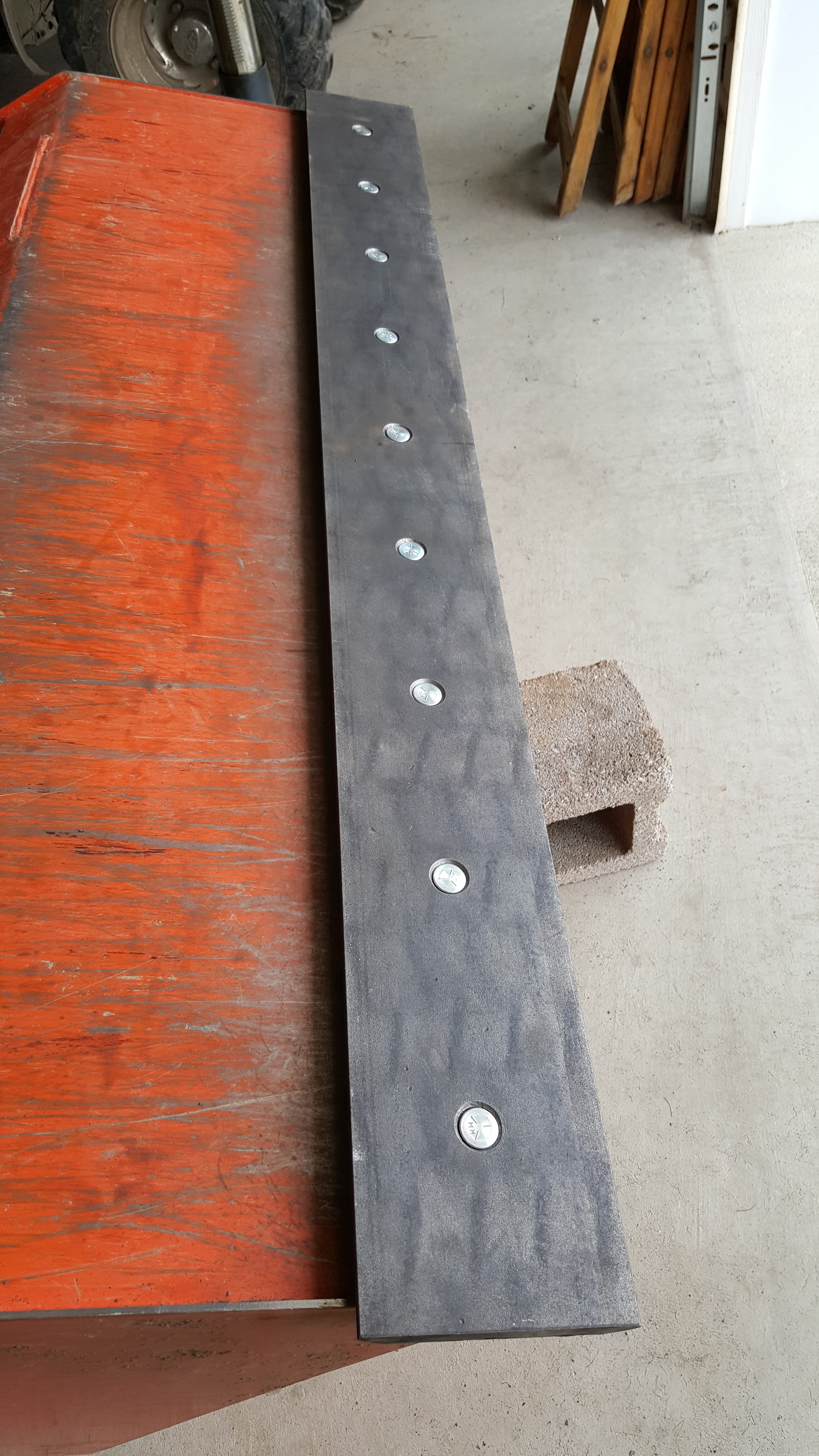

I highly recommend installing one on your bucket. It really strengthens the bucket to keep away from the smiley face. I did mine after the first year on my B2650 to keep the bucket in good shape as I do all of my snowplowing with it. It is best to do it before it gets too bad. The other plus is if you wear out the new cutting edge, you can just spin it 180 degrees and use the other side.
