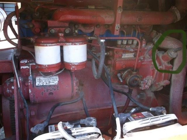

I need some help. I feel silly for asking this but I have not been able to figure out where to add engine oil to a New Holland 1114 swather with a diesel engine.
I would appreciate any assistance that can be offered.

That is good advice. However this is an old machine that I bought used. I have searched for a service manual but all I have been able to find is an operators manual, and that did not show me where to add oil. Interesting enough the operators manual says to refer to the owners manual for information about the engine oil, but haven't been able to find one of those either.

Is there an engine oil dipstick? Oil fill should be top of valve cover or on the side of front engine cover...sometimes both locations.

Ok. I thought the front attachment would go on a 3 point!! My bad. it looks like engine has a hood that you can remove or is on som esort of hinge. There must be a oil sump on the bottom right below the crankshaft (engine oil pan). there must be be a drain hole and bolt right on the bottom or right on the side to drain the oil. There also should be oil cap on the valve cover on top that oi can be added. there must be also a dipstick location on one side of the block above the pan. have you raised the hood yet on this thing?

The dipstick is near the rear of the starter. The oil fill couldn't be seen in that video but I would look at the valve cover area first.

I believe that should be your oil fill circled in green.
