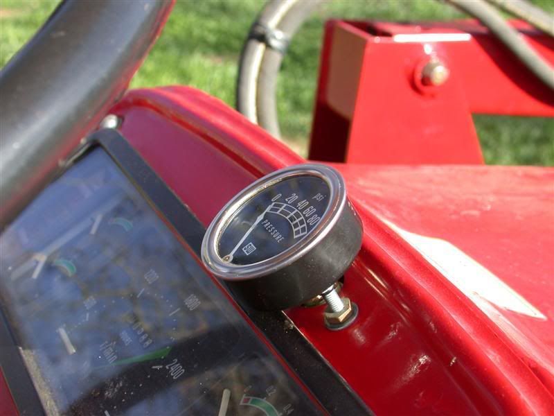

My stock oil sensor went out when I broke off one of the electric connecting posts.
This happened when I was re-assembling the tractor after splitting it. I went to Napa and bought a mechanical oil gauge and finally installed it the other day.
I installed a "T" into the oil sensing port and put the stock sensor in one outlet. Then I used some 1/4 pipe extensions and a cut-off hydraulic hose to run up over the fuel tank (under the body) and over to the dash board. Drilled a couple holes for the mounting screws and hose and then plumbed it up.

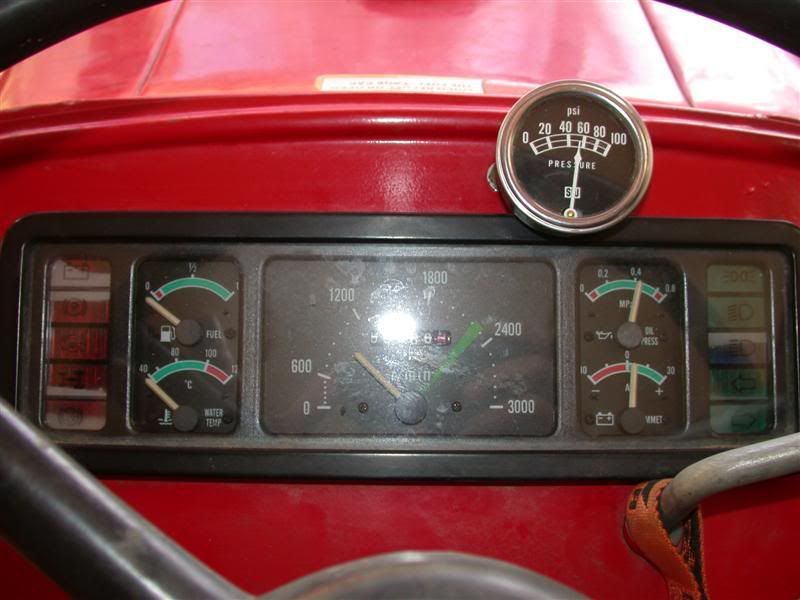

I was also able to fix the stock sensor, so now I have 2 oil gauges. The stock gauge reads in MPa and the Napa gauge reads in PSI. Notice they are not exactly the same but close enough for me. I know with the mechanical gauge I still at least have oil pressure.

Nice job Rob.
I had a similar situation only I removed the all of the OEM gauges and installed a low oil pressure and high coolant temperature alarm while I was at it (just in case something happened while my back was turned, or having too much fun).
Chinese Tractor Owners Association - CTOA Forums - Bulldozer & Excavation Projects & Modifications - More dozer mods
Thanks Bob,
I actually got the idea during the time I had the tractor split.
At the time, my Cummins generator shut down while running because it gave the computer a low oil pressure signal. The computer shut it down. Well, I knew the oil pressure was fine and I just changed and serviced it. So I put a mechanical oil gauge on it while it ran and the pressure was fine. I then called Cummins to let them know about the error and fix the dang thing.
That's when I decided to do the same to the Kama. During the hot Summer days I always got a low oil pressure reading and often wondered it it was really low or if it was a bad sending unit. Now I'll know for sure.
The high coolant temperature alarm is a good idea. I need to have an alarm like that when I try to drive off with the parking brake on.:D
