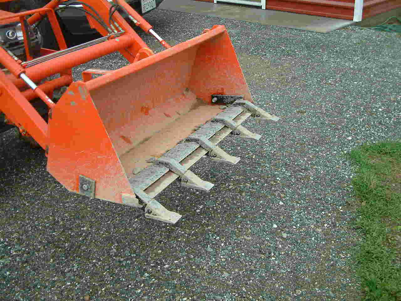

I have a 48" Markham toothbar for the LA302 FEL on my B7510HST. The holes are drilled in the sides of the bucket about 6 inches from the front edge. I have reinforcing around the lower front edge of the bucket, so there was no interference with the holes (see attachment)
I used a 9/16" dia hole saw to drill the holes. Just had to drill a 3/16" dia pilot hole. Hole saws are the way to go for thin sheet metal, IMHO.

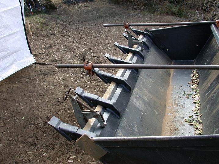

My opinion is that the Markham toothbar will be tough enough for you. From the design concept, the way the toothbar wedges itself onto the bucket and the bolts holding it on the sides, it should be just as tough as welded on teeth, or darn near it. I imagine with the toothbar, like welded on teeth, you could snap one off or bend the lip just the same. If you have concern over the bolt on the side and plan not to remove it, you could weld the side strap to the bucket instead of using a bolt.
I've used the heck out out my 72" toothbar on the 55hp tractor with absolutley no problems in hard dirt, small rocks, roots and boulders. I used clamps to snug it into position firmly before drilling the side holes.

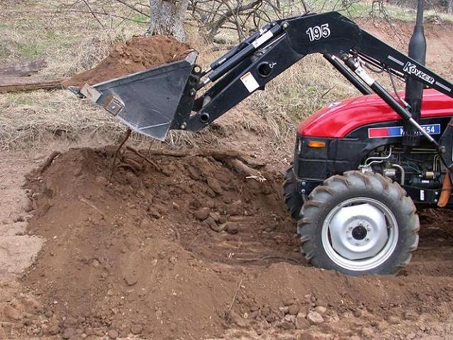

Here it is in use. Check out that dig now...could not do that before. Also check out that 5" diameter root it sheared off.
