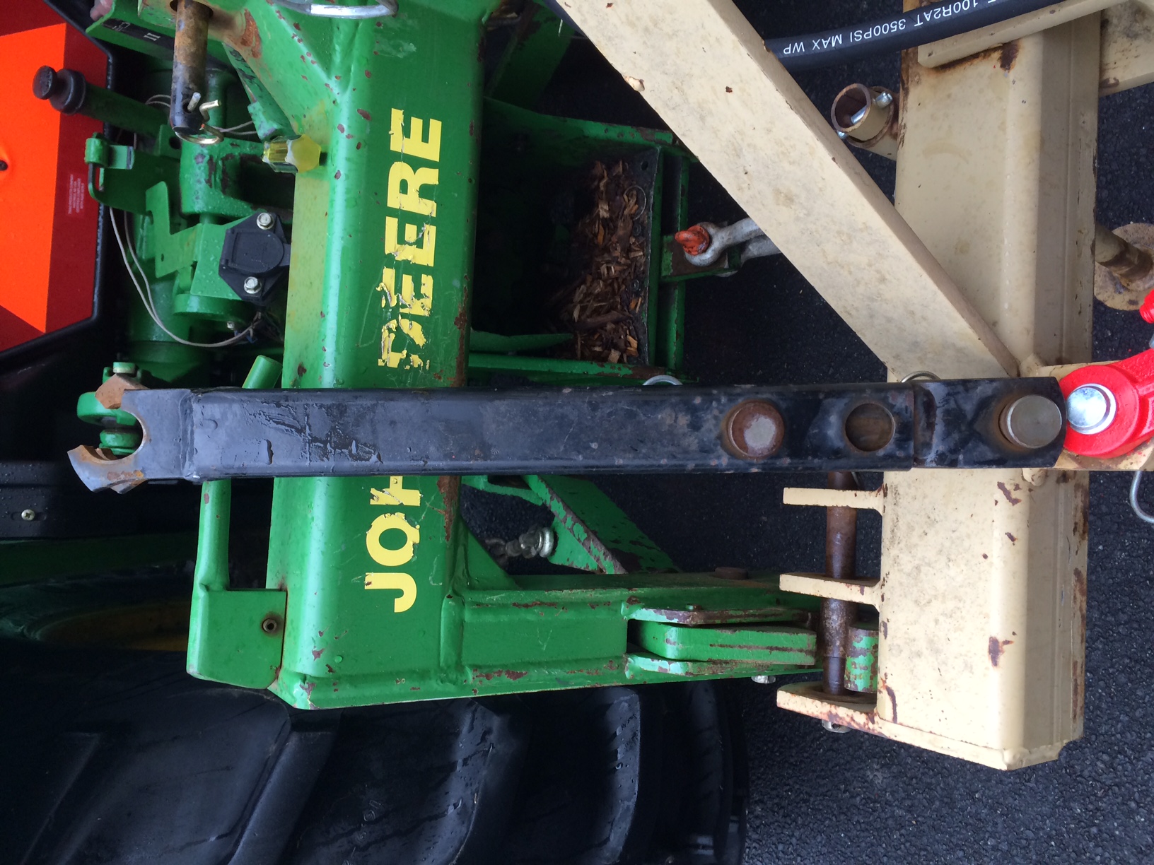

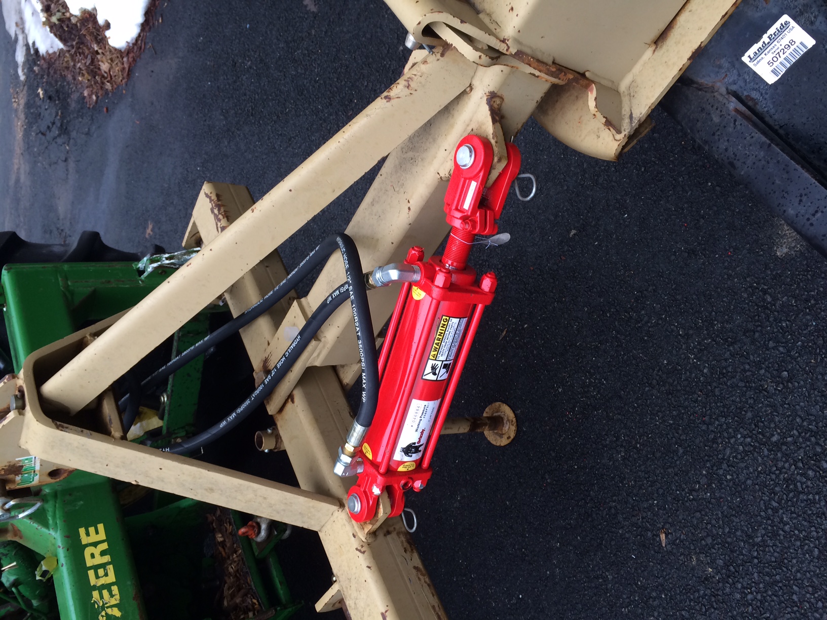

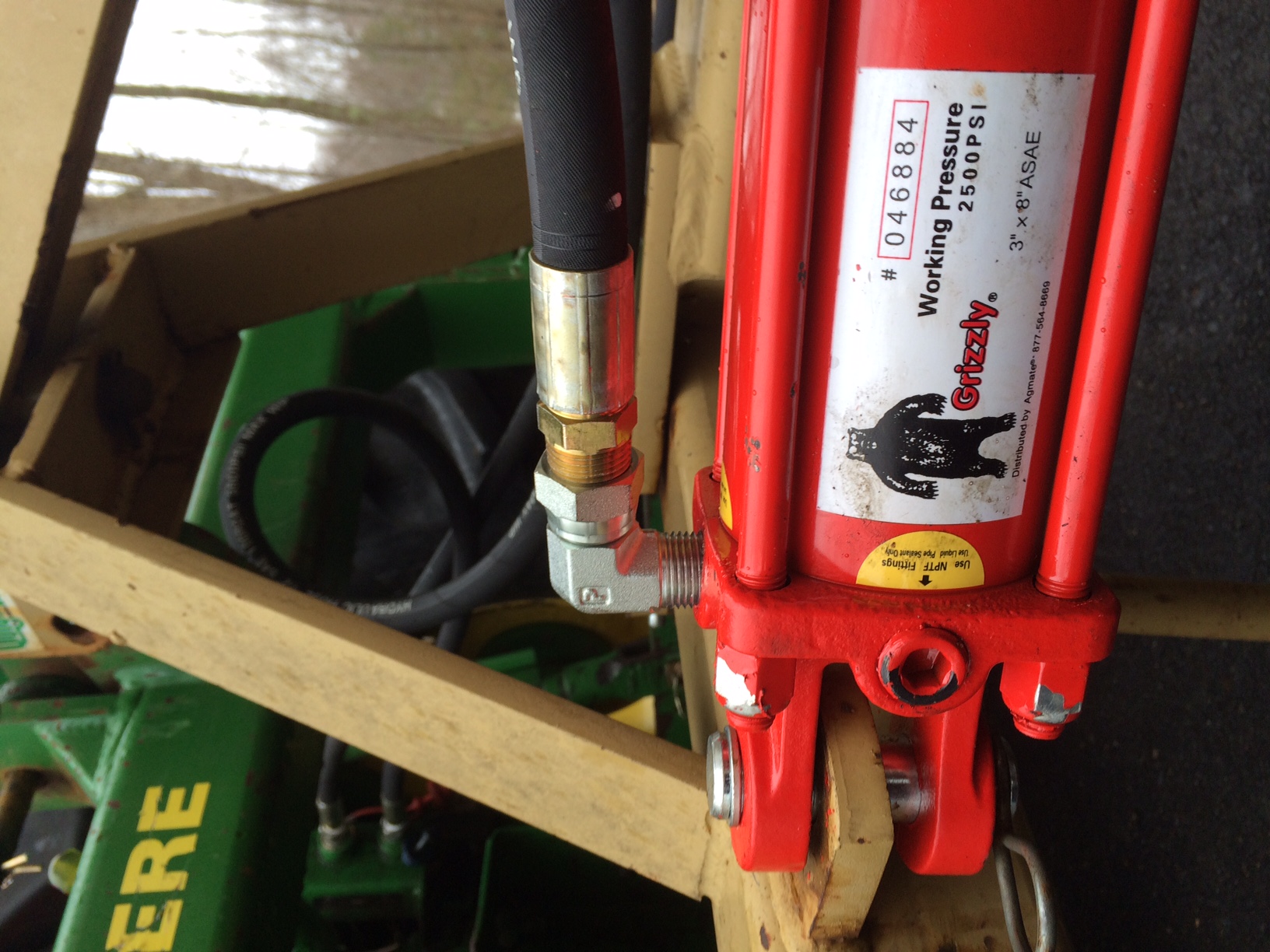

After finally busting the link assembly on my Land Pride Rear Blade, I went ahead and added a hydraulic cylinder. Now, I can offset the blade from the seat. It's not fully automatic like the their RBT series, but it beats fighting with the pins and the blade while trying to move it from side to side now. Looking forward to trying it out in tomorrow's snowstorm.:licking:
