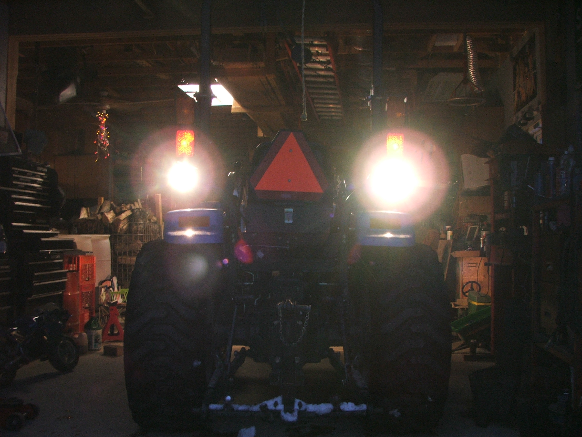

I'm surprised I haven't seen these guards or heard of anyone shearing the lights from their T2220/TC34DA/2035.
I also added the rear work lights, but they won't be staying there. I have some better lights that will be mounted a bit more inboard when I have the time to fabricate the brackets. Word of note, the plugs available at that spot are keyed power, being available whenever the key is on, not when the headlights are turned on. I'll have to add a switch somewhere.

Haymaker,
The setup looks good, I mounted my switches on the gray plastic inserts that are on the fenders. There is just enough room if you bend the tabs over on the connections, here are a couple photos that show where I mounted ours.
I waterproofed the switches underneath with liquid electrical tape. Did you get the light guards at NH? I broke a light cover once but did no other damage and like those.
I used the same connections that you did, I used one for the lower lights and one for my upper lights.

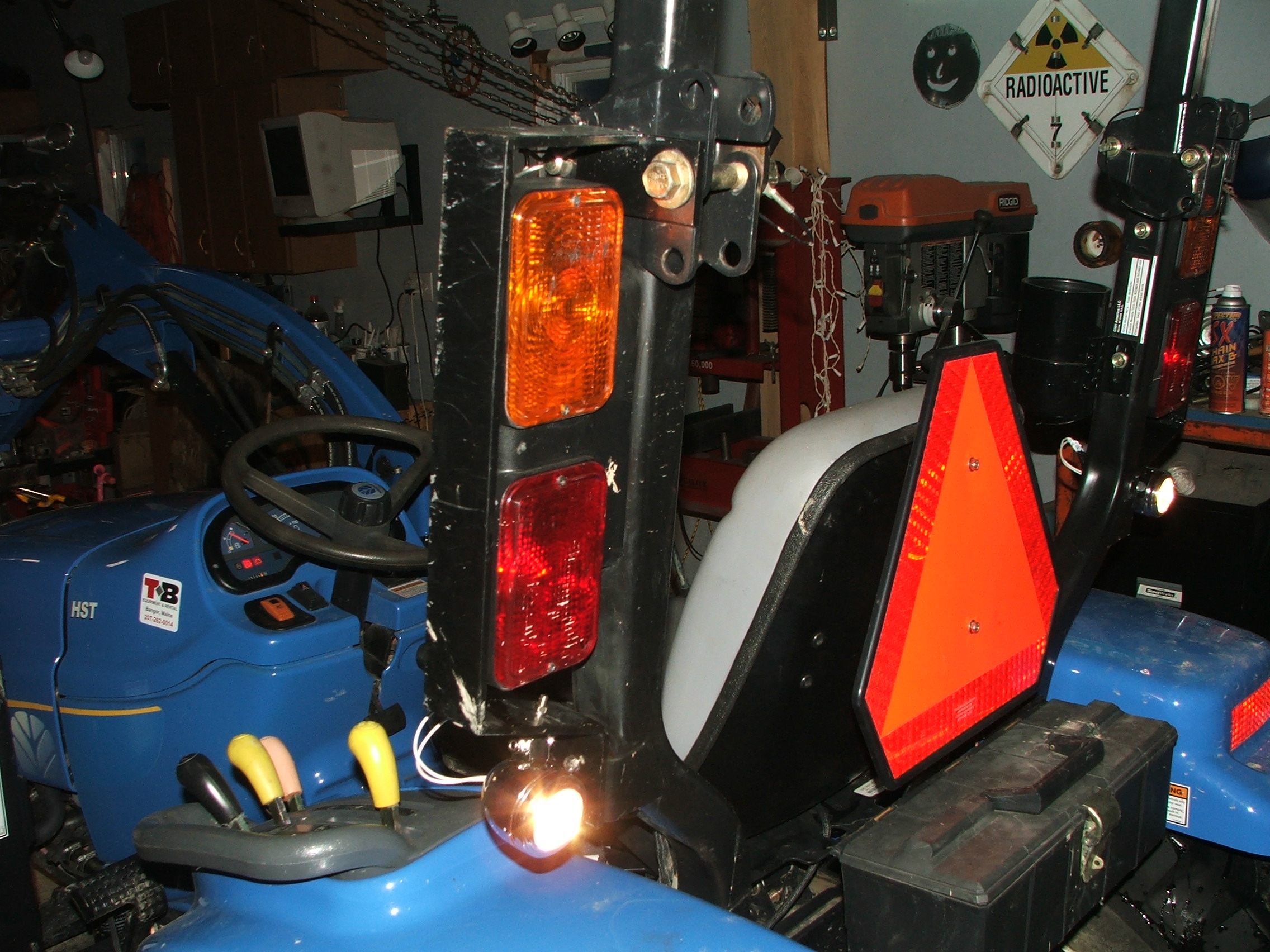

Great idea on the switch mounting! I'll have to get on that.
I made the guards immediately after purchasing. What I mow is surrounded by treeline and I have a few 15yo pines to run around, and that's not counting the stuff I do in the woods. I don't think the lights would have lasted long if I didn't make these.
The top simply fastens under the ROPS pivot bolt, and the bottom has two stainless 6mm bolts where the option work lights are supposed to mount.

I like fabricating. These are simple, a little spartan if you look close. I don't have a bender, so they are made from individual pieces.
But they work!

Yeah, that's all it is. I had some flat stock left over ans simply measured each piece, tacked it on the floor, and kept fitting until it was done. They're stout, but I'm guessing those assemblies aren't cheap!
