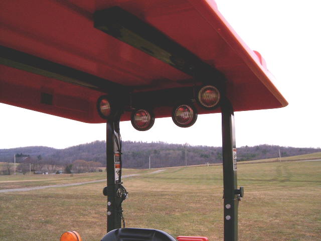

With this amount of light , I may never need to go in the house at night!! Lights up like Vegas at night. Two 55 watt Warn brand floods 6" pointing fore and one 5" pointing aft.
Still need to connect wires to relay/ switch. I only get so much done as a weekend warrior. I study what route to take and bring supplies/tools to the property next trip and get it done.
Dont forget if you use single wire lights to add a dedicated ground to your light bar. ROPS doesnt ground with floppy pins/bolts.

Here are the lights on my DK 35.
2 middle ROPs lights aimed straight ahead.
2 outside ROPs lights angled/aimed to each side.
And 1 factory light behind the seat faces back.

Hey Vince , All kidding aside . Did you need to run off the battery to pull that much power for the added lights ? I'm thinking that I should also do a couple more lights for snow removal this winter. What size wire did you run ?
