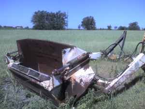

I have decided to go with the WR Long Kit - My local dealer will get it for $571 - the same price Nelson emailed me - I am pleased with the WR Long folks in my first contact with them and it comes with the "thumb" switch for the loader knob.
Also the dealer (small town folks) will install it for $75.00 plus any extra fuild I will need. I should have it done next week...as for the grapple - I found this on CL and bought it for $160.00 it has 8 cylinders and enough 1/2 in and 3/8 in steel to create my grapple - take a look.
